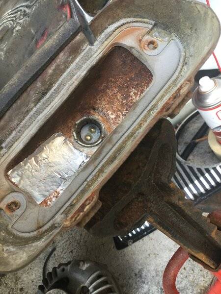

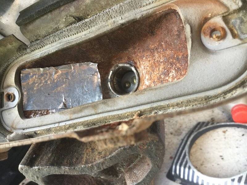

I suggest soaking the housing in white vinegar, until the rust disappears, then rinse and clean it thoroughly. I used a high temp chrome spray and it really perked the brightness up.Here’s a pic of the socket. Despite the rust on the unit the actual bulb holder is clean and apparently ok
View attachment 1186259 View attachment 1186260
