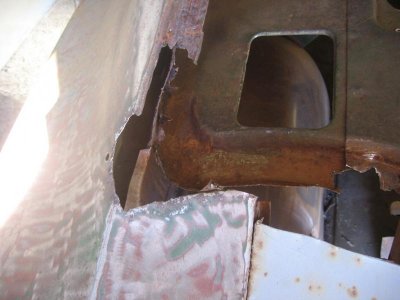

Hello,
I am looking for a photo of a AMD rear quarter panel . Lots of side on shots , but I want one that shows me how much of the rear corner window comes with the quarter. Want to see/know if I need to buy the AMD Deck filler patch(outside) to fix the window corner.
Any help appreciated.
Tony
i don't have pics but,
i do know for sure that you will need to buy
the rear window inner corner pieces when you use a AMD full quarter.
there will be a big gap in that area without it.
they will fit under the quarter.
