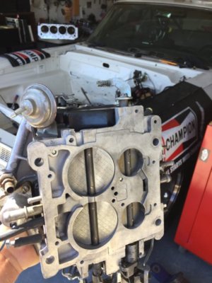

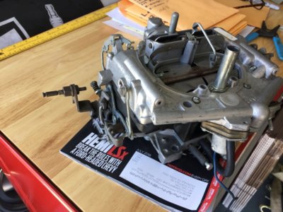

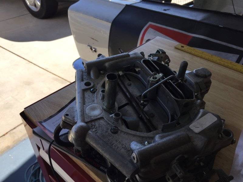

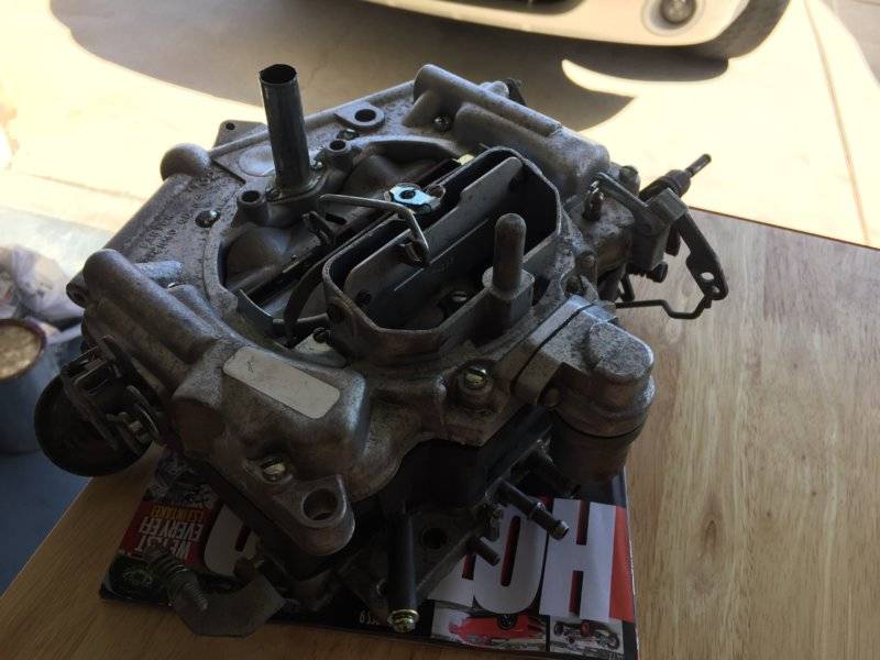

I just found one on a 440 MH I was pulling the fan and clutch off of. Now you got me thinking to maybe put it on the Holley street Dom intake. Can never have to many carb options.
Plus Shipping form SoCal
There are really only about a half dozen T/Q's that really have any significant value,most are a dime a dozen,threw that many out a year ago.
There are basically two common sizes. The smaller 1 3/8" primary butterflies and the larger 1 1/2" primary butterflies. The larger ones are the only ones worth messing with. The smaller carbs are parts carbs.
That 1 is NOT what you want.
That is a later model emission carb...yuck
The carb should be model # 9036s or lower, with a curved top plate and not the flat front
Not necessarily,the 71 340 T/Q's 4972/4973, the 72 6138/6139 and the 73 6318/6319 command a premium if you can find them !
You just want one with as little vacuum ports on it as possible. No added on features like the one above for a high performance/race application.
The one above would work just fine with mild upgrades but I wouldn’t push it. It is still a capable carb. I would use it in a stock or near stock configuration. It can be modified to perform. It really isn’t hard to do. You just have to know what to do to THAT particular carb. There are a number of variations to the base plate, center section and tops.
