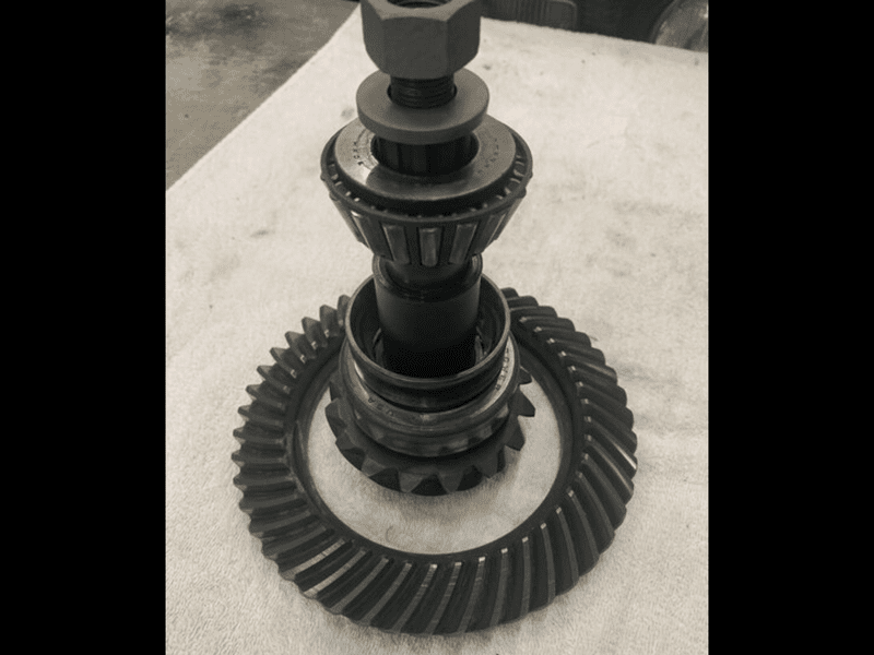

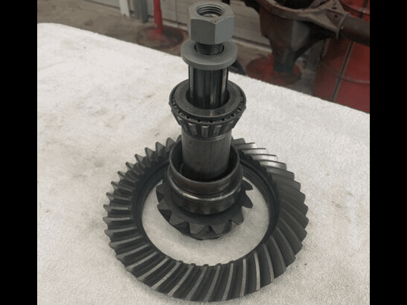

Please help verify/identify this third member.
New 741 gears are much harder to find than 742 gears, and much fewer ratios and manufacturers.
741 has a much undeserved reputation as the weakest.
Most aftermarket gears are for 742/489 cases.
Here is a photo of the pinions and bearings. Look at the size dofference on both bearings. 741 and 489 use same pinion seal, 742 seal has a larger outer diameter because the bearing race is so much larger.
741 top
742 bottom
BE73134D-131E-457D-A40A-3696CD8FBA71.png 29FB9DE7-03DF-466E-A557-C16238EB22D3.png
