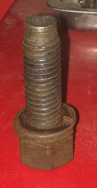

These are the bolts on my 69 charger. Why 12 point ?
And these are the bolts that were installed on the car. I cleaned them and tin/zinc plated them with Eastwood's plating kit.
These are the bolts that came out of my 72 Charger. They are the same thread size on my 68. Those look like after market bolts.
The bolt shown is from the 72. The 68 has the 12pt black anodized.
