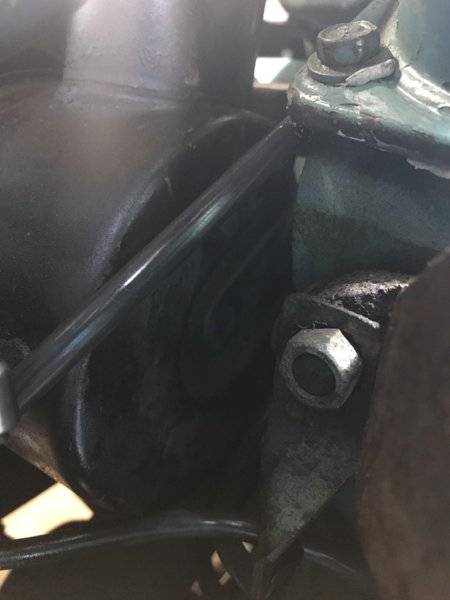

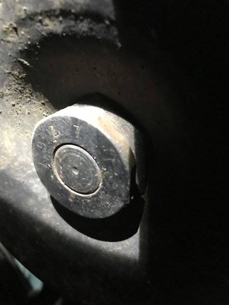

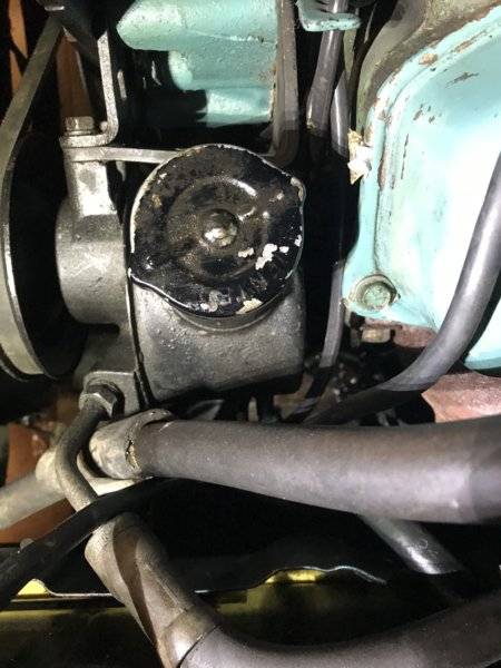

Hi guys. I’m looking for a kit. Is this a TRW small pump, plain shaft. Any stores sell this? Seems guys have to find this one online....oddball.

That is a Federal. Not worth rebuilding just fit a Saginaw.
You can buy a kit of 440 Source.

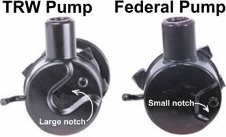

They look similar but it's easier to tell if you can see the back.
I mentioned TRW because in my pic I posted, to me it did look like the one on the left Photon440 posted. What did I miss? Thanks guys.
Actually now that I look closer, it does not look like either....but closer to a TRW
Yes that is small TRW pump. You can tell by the shaft being solid. Federal pump has a 3/8" Threaded hole in shaft. Both can be rebuilt. And that federal pump was a hemi pump and AAR Cuda, and the non core cost is about $600 at RA now. So I am not sure I would just scrape one if you had one.:)
