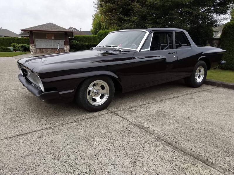

I'm getting old and the "Old Armstrong Steering" is getting to the point where l don't enjoy driving my car anymore. Is there anything new on the market for power steering options and still keep sort of a muscle car look :lol:
