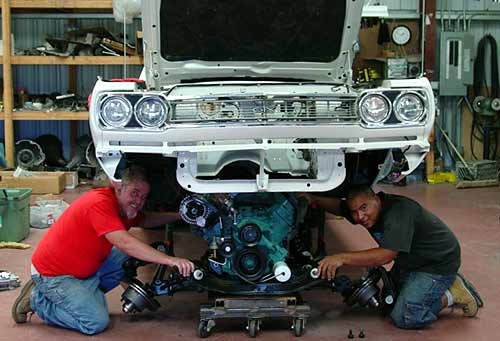

If you are going to pull the motor for some "Other" reason, Drop it out the bottom still attatched to the K-Frame like they assembled it in the factory, just in reverse.

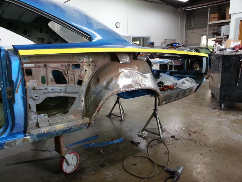

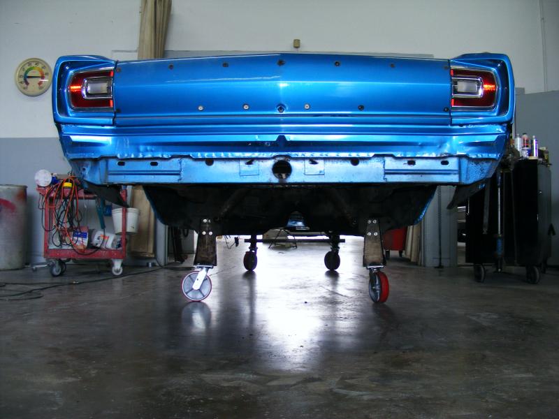

you won't have trans fluid leaking all over the garage and you won't do any damage to the engine compartment or fire wall. I have my 68 GTX up on the Auto Twirler
body cart and it supports the car very well to R&R a quarter. See pics: DSCF8342.jpg20130715_144438.jpg68gtxconv28.jpg
