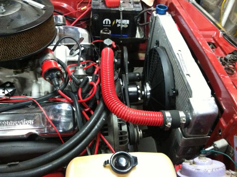

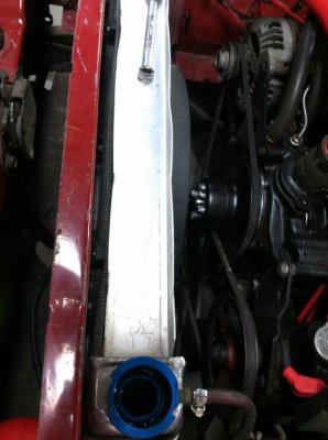

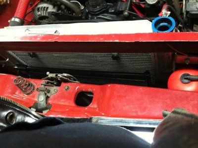

I will try to address everything put up thus far. I am try'n to get my phone & pc to cooperate to add pics of everything anyone wants.
this is a freshly rebuilt engine but I had the same problem with the 383 also. I have only ran the car in the driveway & garage so far, so I don't know if it will run cooler down the road yet. I do not have a shroud on . just an electric fan mounted to the rad. with previous engine I tried a new factory clutch fan...
I examined the pump prior to install & found no signs of contact w/ the housing. I had been using a 180 thermostat & just put in a 160 that I drilled a 1/8th hole in. I filled the cooling system through the opening where the thermostat sits till no more would fit, then the rest through the radiator. I then let the car sit untouched for 3 day with the cap off. when i started the car i could see coolant rushing through the cores into the tank. the coolant level dropped & i topped it off. it burped a few times before i capped it. I do have a recovery tank attached to receive coolant.
I did have the radiator flushed, boiled & tested. the block & heads were tanked & blown out.
I distinctly remember putting the head gaskets on so you could read "TOP" stamped in to the center ears on both banks.
I had someone suggest the problem might be the head gasket water ports are too small & pinching off the flow?! I never knew there were different head gaskets for different years. Anyone have insight to this? The long block is 1977...
I did test my radiator cap tonite & found it pops a lil early (15 instead of 16 psi) & once it pops open it will not reset & hold pressure until it is removed, then reseated?!
I have a fuseable link coming from off the starter relay to the gauge & hte other wire is now attached to the same post to bypass the gauge. Since the bulkhead connection failed I was either going to jun a wire through the bulkhead w/ no breakable connection or just run a wire from the alternater to the battery.
Everyone's input is GREATLY apperciated! hopefully my reply makes reasonable sense. I will get pics post asap!

try'n to loload a couple pics
