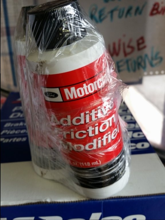

To add to my earlier post...can anyone say why GM/Ford additives does the trick while Mopar wouldn't?
Here's a pic
The Mopar stuff works well also. The ferd stuff is my personal preference and I've done quite a few rears, nit a one has chattered, so I stick with it.
