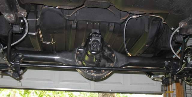

while this is a 72 setup will fit straight onto a 71 spring

Sweet - but isn't the 71 sway bar go above the rear end housing and the 72 sway bar go below the rear?
I prefer the one that goes below the rear as it would not interfere with tailpipes.....:canada:
pre 72s B bodies didn't get sway bar ever so there is no rear sway bar going above the axle in any B body ( maybe some aftermarket, but not originals ). I know E bodies got rear sway bars shaped to go above the 3rd member, but dunno when was the first year for these. Anyway, The one you need is 72 B body and will be a plug and play job.

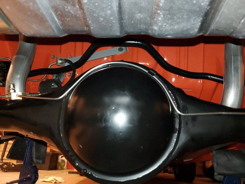

Hmmmm, no interference

Thanks rrTor-Red for posting that pic. I assumed that there would be no room for tailpipes.....you proved me wrong!
