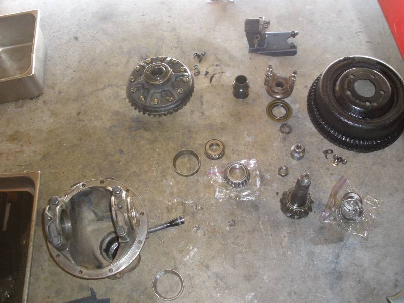

I just went through the same thing. Had a pinion leak . I didn't really have any noise or movement. this is what I found.
went back with a crush sleeve eliminator.
It would have made noise eventually!
