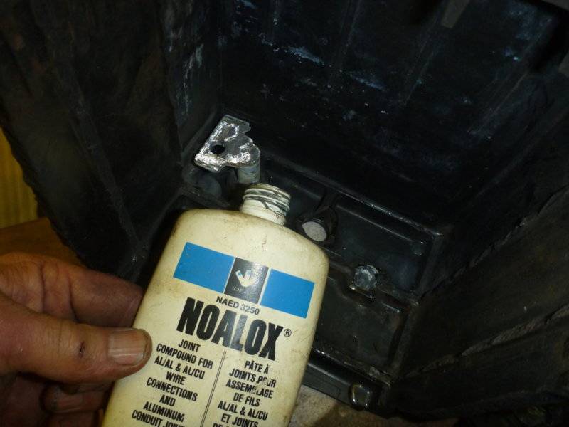

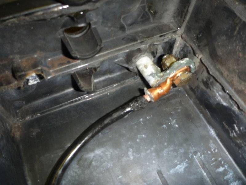

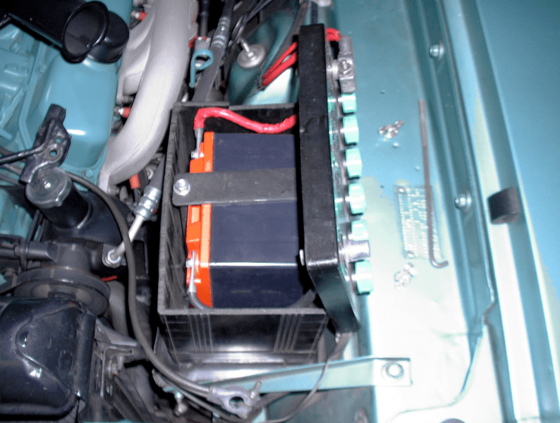

Yes I cut the top off right below the lid and cut the bottom too..@strokie So did you just cut the case top off right below the lid?.. or how did you get the bonded top off? Or did you buy it with the AGM already inside??
Thanks, always good to see a different approach.Yes I cut the top off right below the lid and cut the bottom too..
It's really a big mess to clean the inside.
You must install helicoil in the terminal to screw your bolts.
