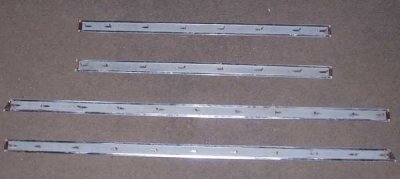

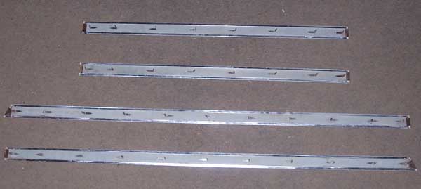

I need to remove the old woodgrain from the door panel trim to restore the metal before sticking on the new woodgrain inserts on the trim. Least destructive method, please. Any help would be greatly appreciated.
