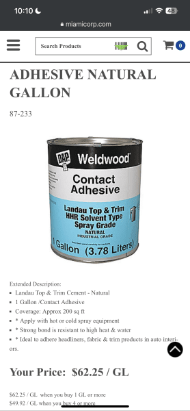

When installing headliner use a good contact cement. You need one strong enough to hold while you stretch. It makes all the difference. If you use the wrong stuff you will end up with wrinkles. I tried several BEFORE I used this particular Weldwood Landau. Others mentioned this but it’s expensive and I believe the smallest you can get is a gallon which is overkill. BUT it’s worth it. This stuff is extremely strong and I was able to get professional results doing it my first time. This…..mic drop……..

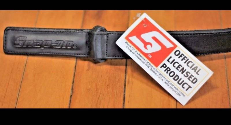

Watch out for your belt after painting! Use a fender cover. There are soft belts like the one pictured by Snap On.

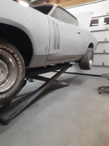

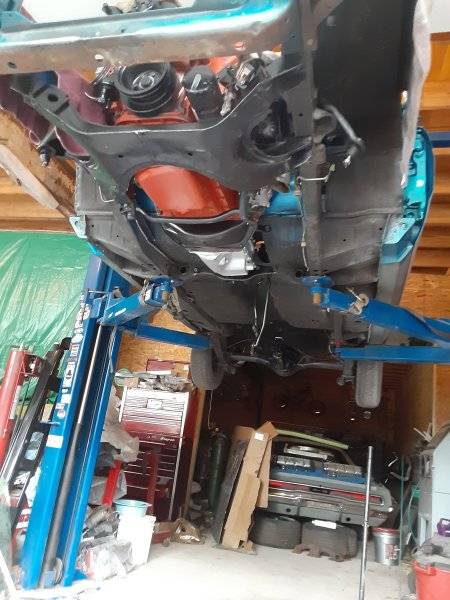

Lifts are helpful too,I can't have enough of them. I have a two post work lift,a scissor lift and five storage lifts. Money well spent! Work civilized!
