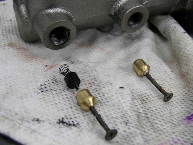

I didn't know if it would have been built into the proportioning valve or not. Would I be able to see one if I looked into the old master cylinder?

You wont be able to see it unless you pull out the brass seat where the line for the rear line attaches to the cylinder. I have one apart right now, and will take a pic of it tomorrow for you.
