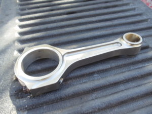

I have a custom set of small block rods that have a 6.298" length (vs 6.123" stock connecting rod length). They are standing by inside my 305 Mopar de-stroked 340 long block to be finished some day soon (see photo).

I have those same rods in my 340 street engine. They are strong. But very heavy. The best advise I've seen? Find the stroke you want. Find a light piston that is as short as you feel comfortable with. Connect the two with what ever length rod fits. For a given stroke the biggest advantage of a long rod is a lighter piston.
