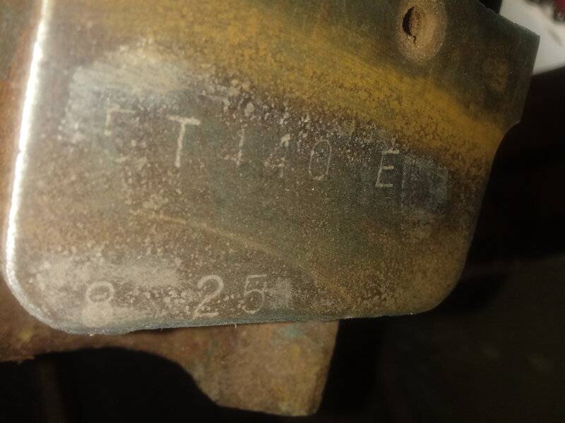

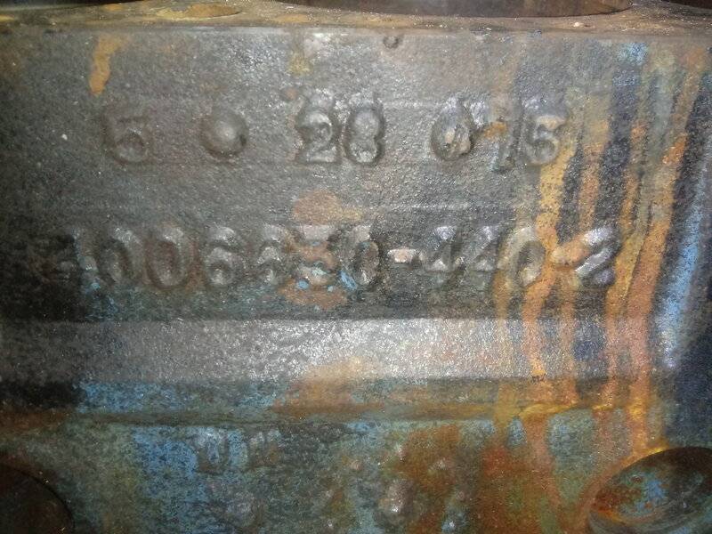

Bought this 440 block the other day, $250 for it and a 727. Here are pics of the numbers on it. Are these typical numbers for winnebago 440s? And looks like it was built in 1975 ?
I also just bought a 1973 Winnebago!!!
These are ones I can find in my book:
5= 1975
T= Trenton engine plant
440=440CI
E=Cast crank
8=Aug
25=25th
That 8/25 is assembly date,
Casting date is on side of block.
5/28/75 I think it reads.
then the 4006630-440-2 is on all 75-78 440RB
The "2" after the 440 I am not sure, it MAY be 2nd shift, someone may chime in with more info.
