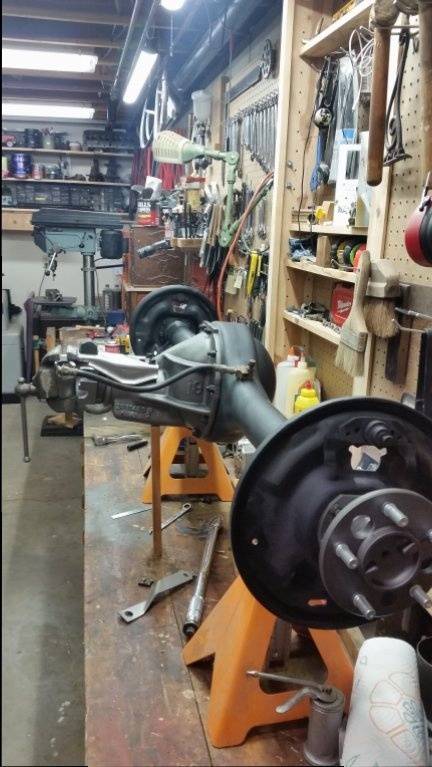

Wondering what the practice is to apply sealant to the pinion spline while mounting the yoke?
I had one center section that had sealant slopped all over the spline, but apparently not the other.
I read the FSM and no mention of applying sealant to the spline during reassembly.
Anyhow trying to figure out if I'm popping the yoke one more time and applying sealant.
