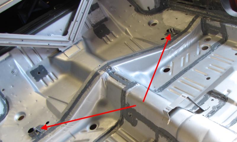

You're a big dude goon, should be a breeze for you! There is 2 hook brackets spot welded to the rear pan (one each side). They face the rear of the car and are located more towards the front of the seat. Object of the game is to push down to disengage the heavy metal rod that's mounted on the bottom side of the seat, from the armpit of the hook. Once that rod clears that, you'll need to push the seat towards the rear of the car at the same time, to clear the tip/end of the hook. Walla! Sounds real easy, but usually sucks...lol Just being honest. Good luck, don't blow a gasket reefing on that puppy.

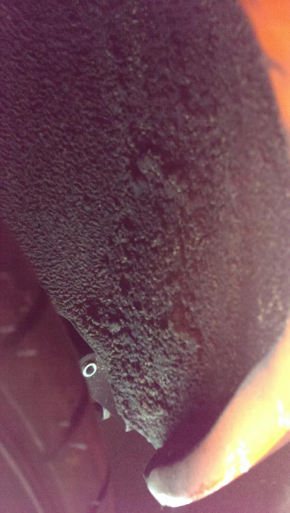

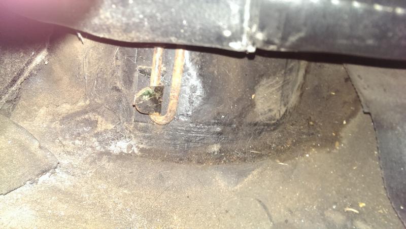

So I see a latch on the bottom of the rear seatback that loos as though I have to back off a clasp from within the wheel tub. Problem is the previous owner layered the inner wheel tubs with that rocker guard stuff. Does this seem right?
That's it. Just bend those straight. Pull the seat forward at the bottom and then it will slide up a little, unhook at the top, and then out. OH and even though they look easy to bend, nope, they are quite strong. Pliers will be helpful.....unless you run visegrips for fingers!!
Thanks gdrill! I didn't wanna bend the tab until I heard it was ok to do! Pliers be getting used!!
