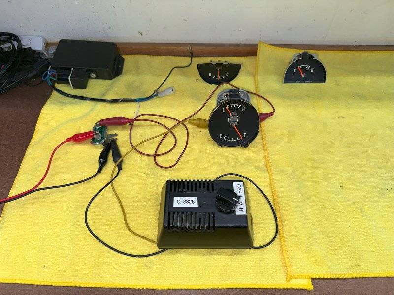

Seriously guys. All the rallye gauges are, are volt meters in disguise. There is nothing extremely technical with them. They run on a pulsed 5 volts. If your voltage regulator isn't working correctly or sticks they get smoked. Full scale requires 10 ohms of resistance and the empty/ cold / zero oil pressure line requires 74 ohms.

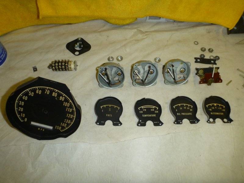

All three are identical gauges, just different labelling..

I think it's fair to say they are more like ohmeters.
