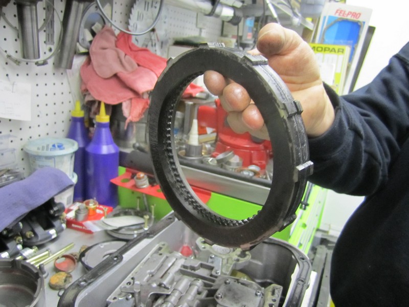

I found out when the unit was removed and we found the clutches & steels welded together.
Half of the problem found-....good find
