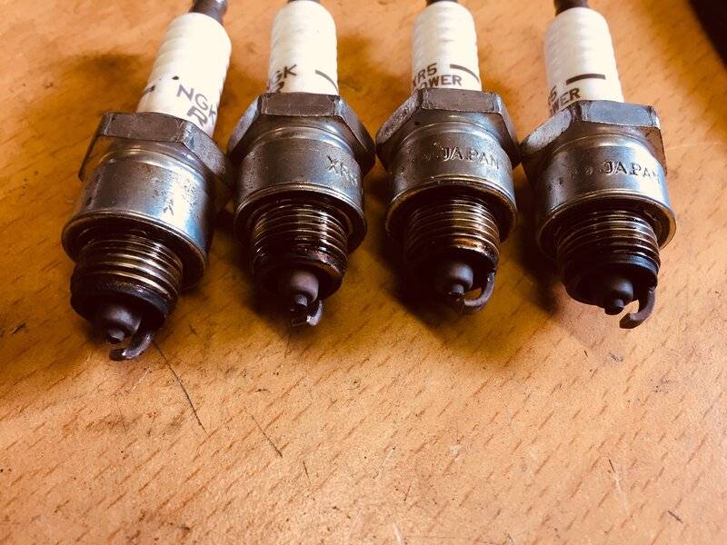

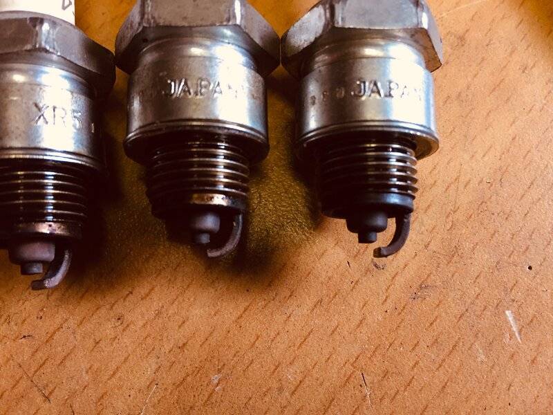

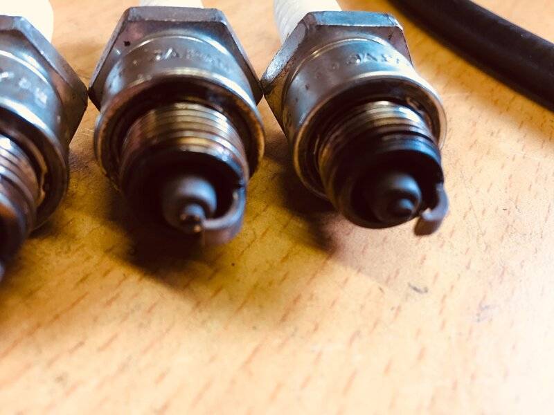

I've "side gapped" my old plugs, hopefully tomorrow i can go for a drive and will see if there is any changes.
I pulled the "side gapped" plugs out of the 300 cu in 6 in my F150, looked just like these. The .065" + gap was probably more to do with the 90000 miles on them. Still ran ok though.
Those plugs are rich and maybe oil fouled
What carb and settings
You have oil on the threads and or plug gasket ?
Yeah, they will wear out fast and on 1 side only now.
But trying on an old set of plugs first, then again $4/plug.
I am still not sure if using any Iridium plugs would be worth it.
I know. Engine runs pig rich. At the moment i am using a Holley Street Avenger 770, i am waiting on an order from Summit with some materials to rebuild my 750 double pumper and try that one again.
I already spend a lot of time on this 770 to run leaner but with no real success.
It needs a rich idle to run decent so the idle screws are quite far open, anything smaller then a .72 primary jet and it will cause a sag when speeding up.
It's not consuming any oil though.
