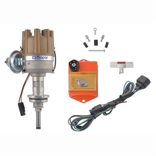

Just Wondering What Wiring Harness I Should Use With The Spectra Premium Electronic Ignition Distributor I Purchased For My 440 Engine In My 69 Roadrunner?
Year One Has A Few Options.
Do I Need An Ignition Box and What Coil Should I Run?
Thanks Guys

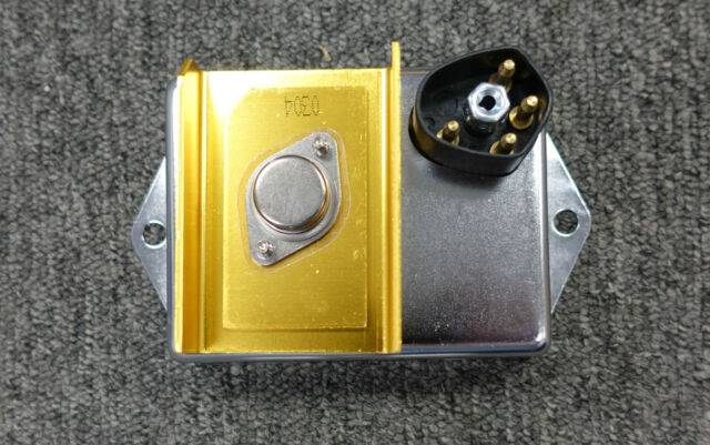

There are chrome ignition boxes and the harness will come with them. There are blue ones and orange ones as well. All of them should come with the harness that plugs into that distributor. Pretty sure each color has a specific RPM range. I think the chrome one has a higher rev limiter. Not 100%sure on this though.
Thank You. The Car Has No Wiring Harness At All So I’ll See If I Can Find The Proper One For An Electronic Ignition. Like The M&H Stuff From Year One.
I ll Order The Box Tonight.
The harness goes to the box. Then it has leads for the coil and distributor. You WILL need it for what you plan on doing.
