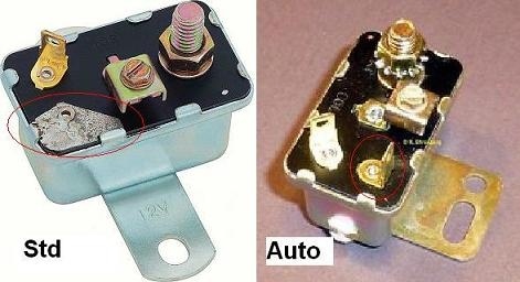

Earlier starter relays were different and were for standard or automatics. The standard relay got its ground full time from the case bolted to the firewall and could be started in gear. Auto's used an actual neutral safety switch in the transmission. It sounds like you have a relay for an auto but it doesn't matter as long as you supply ground to the G terminal. If you're worried about accidentally starting it in gear, you will need to rig some sort of normally open switch from ground to the G terminal of the starter relay. Adapting a later model Mopar switch might be the easiest.

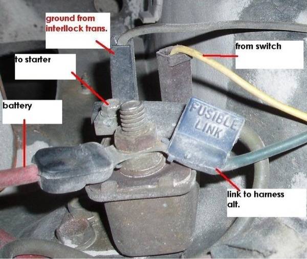

OK try to reanimate this thread. I am building a 69 Satellite from ground up here in Germany. Never had a Mopar before.
On this picture above we have this blue cable. This cable gave me some trouble. It is shortcut to negative battery/ground. Where does it go to? How can I fix this problem? It is the first time I had a battery connected to the car after paintjob...
Amazing nobody here has mentioned or asked about the year.
Up to 69 the starter relay was chassis grounded for speed and gets the NSS signal from transmission on autos
Since 70 4 speeds got same starter relay than autos, but the safety ground comes from clutch pedal being a green wire throught the firewall with a grommet. Autos remain the same
