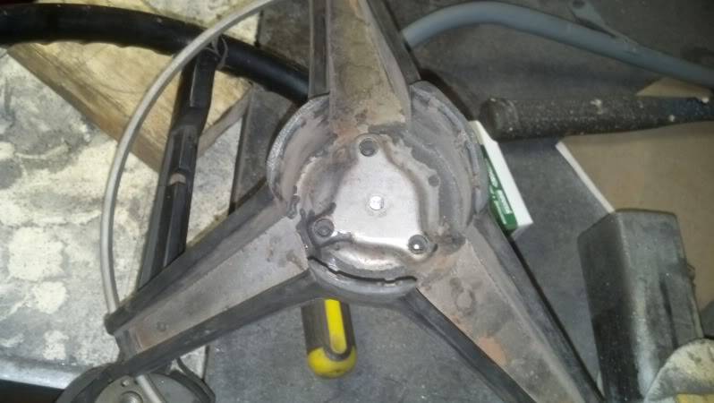

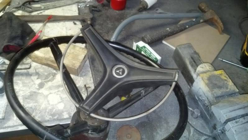

I purchased everything separate, and I am piecing it together. Can anyone tell me how this goes together? Am I missing any pieces? Any pictures? Thanks!

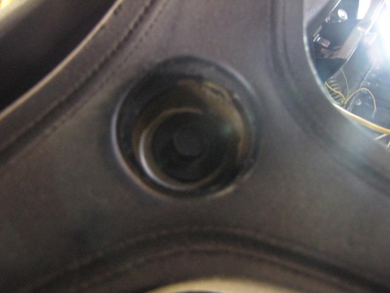

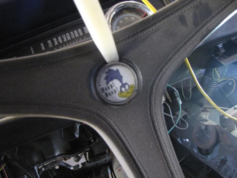

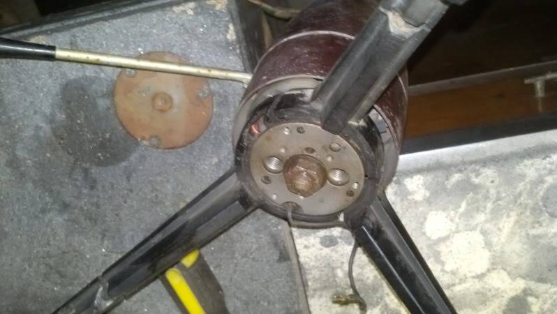

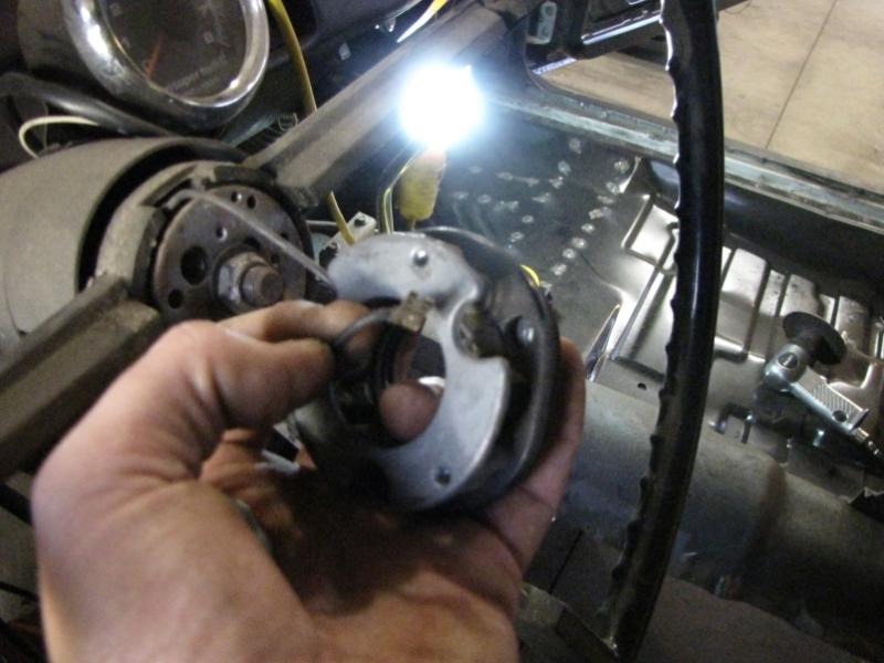

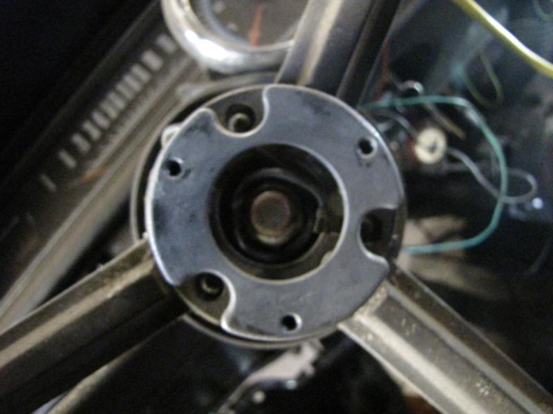

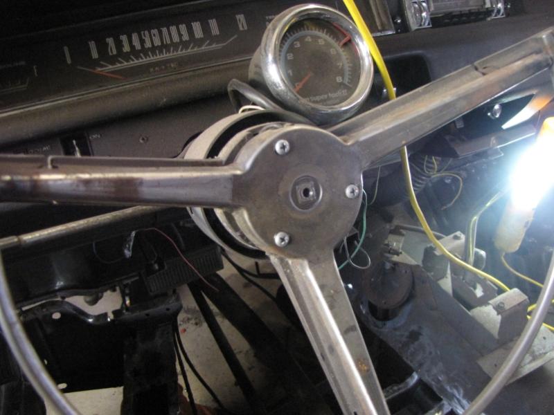

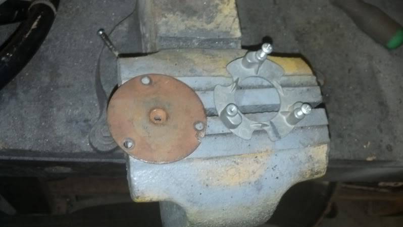

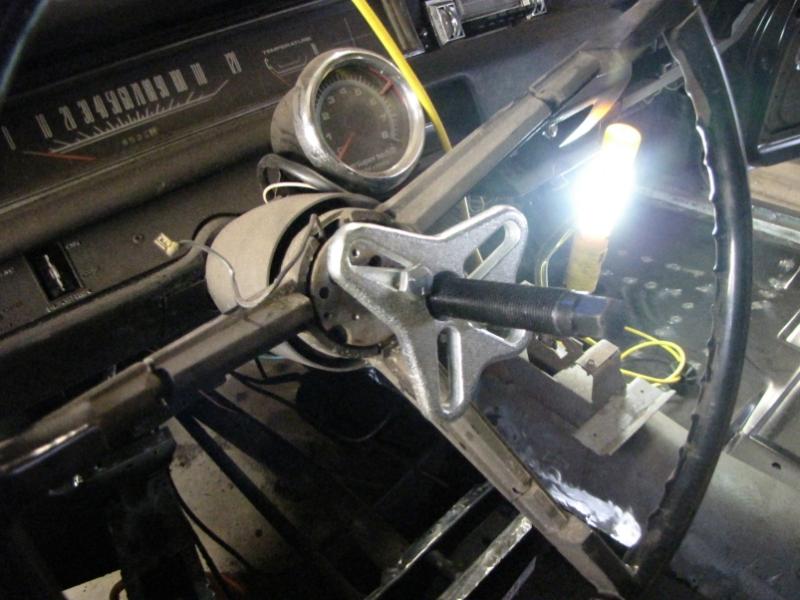

Here's some pic's of removing a 3 spoke wheel...Should be pretty self explanatory. Hope it helps.
Great photos Propwash. My 68 satellite has an aftermarket grant wheel and a found a stock 3 spoke original I want to install. It only came with the wheel though and no other parts. Can you list the names of each part I need that goes underneath the wheel for installation so I know what I'm looking for?
Doesn't look like the one in my '68 or '69 Chryco69. Couldn't tell you if it would work or not. Sorry bud.
Believe you're looking for this:
http://www.ebay.com/itm/1967-68-69-70-71-72-NOS-MoPar-Cuda-Dart-Valiant-Coronet-300-Fury-HORN-SWITCH-R-T-/400326636327?pt=Vintage_Car_Truck_Parts_Accessories&hash=item5d3553b327&vxp=mtr
You already have the cast metal piece that bolts to it.
As Propwash stated your are missing the horn switch. I should have some for 25.00 ea.
