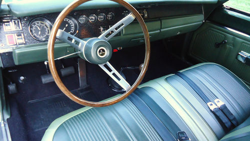

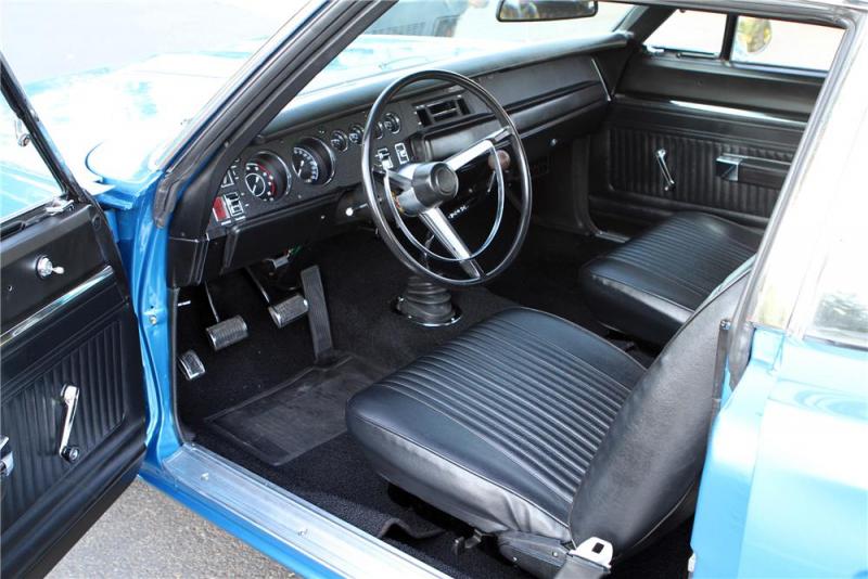

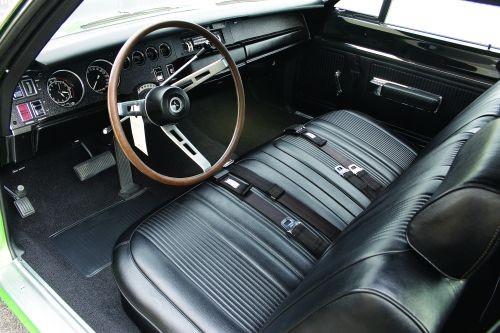

  • 69 Super Bee J Code Hemi 4 spd Mr. Norm's Promo Sale Bank Car Interior.jpg
Budnicks posted a good selection of pictures for reference. Here is the dealer sales literature explaining each one. Only 3 were available on the Super Bee.

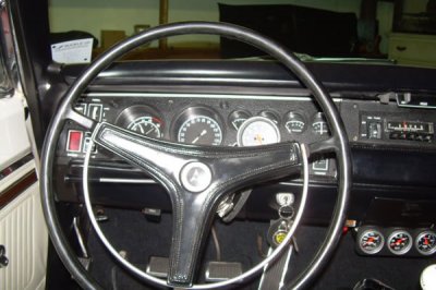

Where else can you get this kind of education? Nowhere. Looks like I have S81 option on the Coronet. (On the Bar, put a Momo on.)

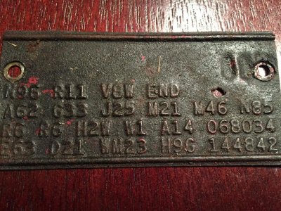

T69B,
That is a nice ride you have there. Yes, you have the standard 1/2 ring wheel on your Bee, black in color. I am not an expert on SL tags, but will give it a go. There are other members who are (DLH) and will chime in if I am off base on anything with the decode.
I am starting by inverting your photo.
Line 1:
E63 - 383 HP Engine, 4 bbl, 335 hp
D21 - Manual Transmission 23 spline
WM23 - Coronet Super Bee Hardtop
H - 383 Engine
9 - 1969 Model Year
G - St Louis Assembly Plant
144842 - Sequence Number (VIN)
Line 2:
R6 - Top Color, Red
R6 - Body Color, Red
H2W - Bench Seat White, High Trim Grade
W1 - Upper Door Frame Color - Eggshell White
A14 - Scheduled Production Date, October 14, 1968
068034 - Vehicle Order Number (VON)
Line 3:
A62 - Ralleye Gauges
G33 - Remote Left Door Mirror
J25 - 3 Speed Wipers
M21 - Roof Drip Rail Moldings
M46 - Simulated 1/4 Scoops
N85 - Tachometer
Line 4:
N96 - Fresh Air Hood
R11 - AM Radio
V8W - White Transverse Stripe
END
