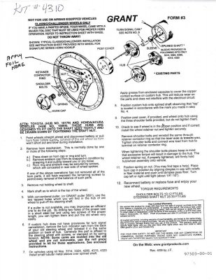

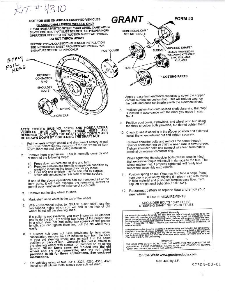

How about a picture of the wheel? On wheels that are painted, Grant provides a flat disc of aluminum foil with adhesive on the back to apply to the wheel so the horn cap can create a ground when you push on it. I've had many aftermarket wheels and they ALL worked the horn. And yes, if you take off the center cap and ground the wire to the steering shaft, the horn should blow.

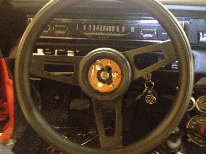

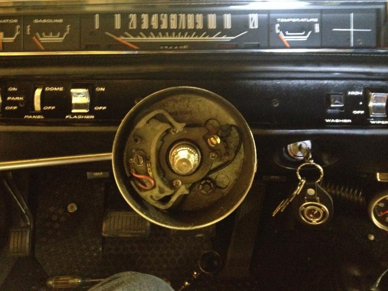

I was able to get the horn to work after I took off the new steering wheel. So my problem is grounding thru the new steering wheel. Where does the foil go??

Read the instructions, the foil goes on one of the surfaces to allow the horn button to ground when u push the button. Been a while so I don't exactly recall, but the directions were decent as I recall.
Everything works until I tighten the steering wheel. The horn works as I touch the wire to the shaft, but it doesn't work after tightening. Do I need to adjust the brass screw? The instructions don't say where the foil goes.
Did your steering wheel installation kit come with a hub with ring to make contact with that spring loaded brass wheel??? This pic may not be the exact same one but yours should have a copper ring like this to make contact with that brass wheel. The wire from it should go to the horn button and then is grounded when the button is pressed "just installed one".beetle%20and%20camper%20parts%20grant%20steering%20wheel%20boss-255x270.jpg
Yes, it came with the copper/wired ring. It also came with a washer and a alum. Foil, but the instructions do not say what to do with them.

Thanks for everyone's help. I was able to get the new steering wheel and the horn to work. The post cover was too deep, had to trim it 1/4" to get it to work.
