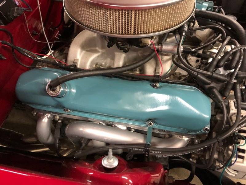

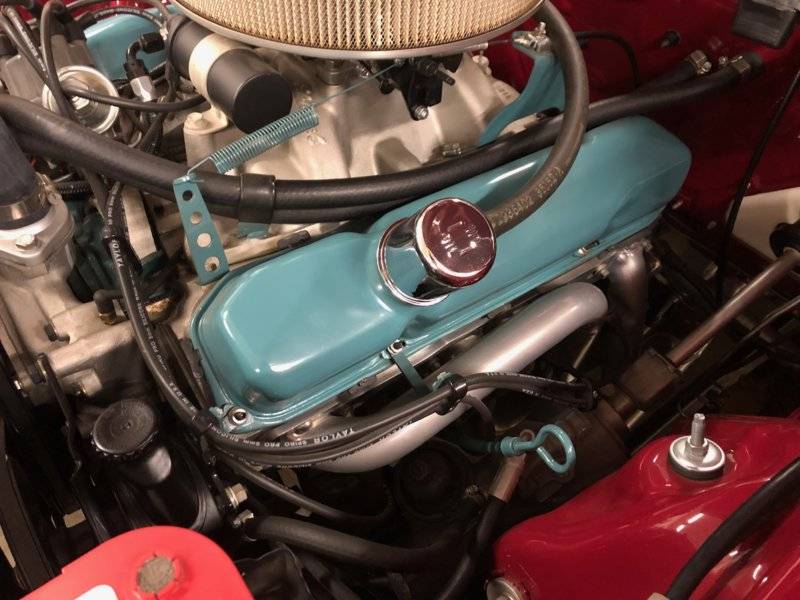

I’m running stock valve covers on my stroked B engine with Crane roller rockers on Edelbrock heads with a .501 lift Comp cam. Baffles are still in the covers, no interference.
Wow! Cool.... Which covers if you dont mind me askin?

Just stock covers from a 69 383 Polara. I’ll see if I can get a picture later. I did add a piece of tubing to the right side cover so that I could use the earlier PCV.

A pic would be cool to see. Thanks.
