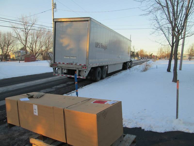

I got the call Tuesday from the Carrier, UPS, and scheduled a Friday delivery. I'm hoping the truck has a lift gate to get it on my cart, and roll it up my driveway...
Mine came on a semi with a lift gate trailer and cart, he rolled it all the way up to my driveway to the pole barn.

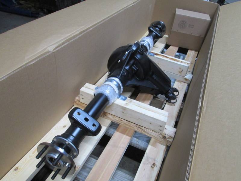

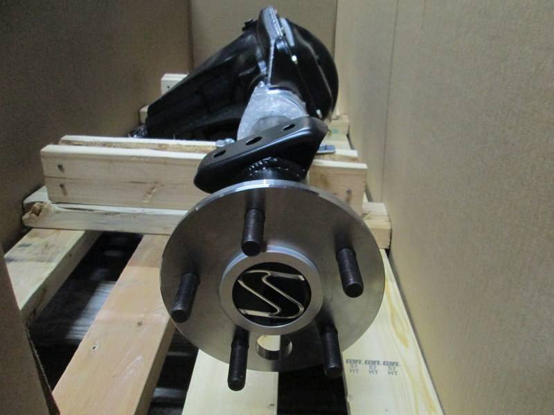

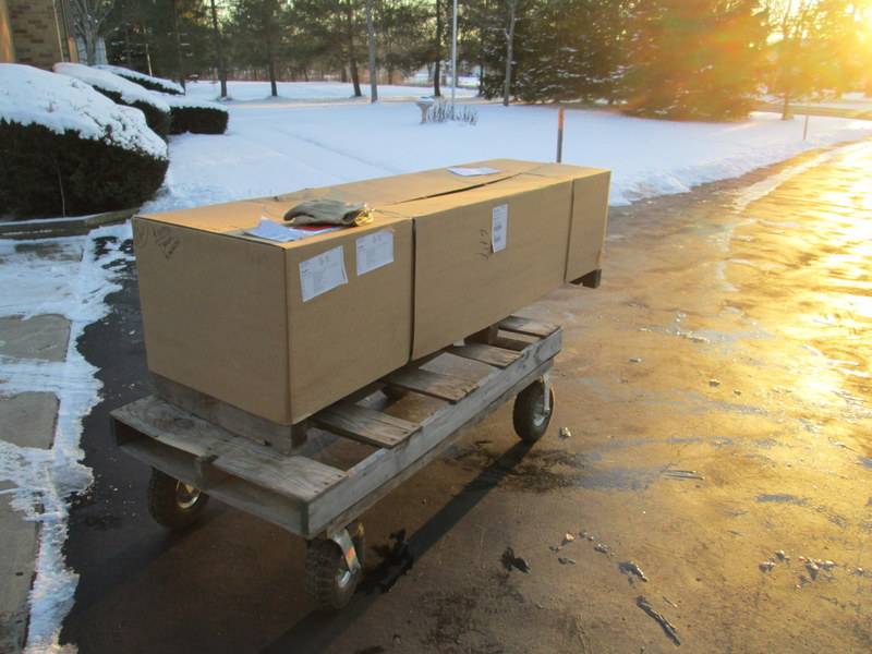

On Friday my Strange S60 was delivered, as the sun was heading down. No liftgate, but the driver and I got it off the truck, and onto my cart. It's stored in my meat freezer of a garage, until the warmer weather moves in around April or May, I hope...

Can you measure the length of the box?

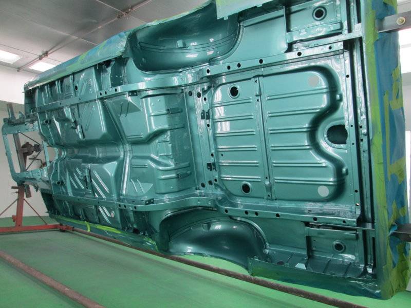

I think the only things I need to pick up yet are the U-bolts for the rear end assy, and once the shell is painted, the car can get it's start to go back together. It's been about a 4yr journey, so far...
