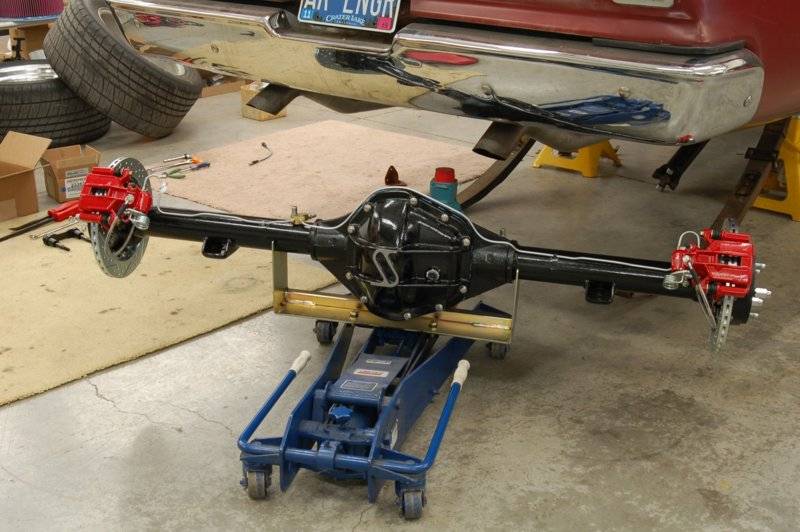

Cass put together a S60 for me with the S Trac differential, 3.23 gears and disc brakes. I put it under my '65 Coronet last summer and it worked great. At your power level Cass will tell you to go with the S Trac. If you have a big stroker engine you might want the 3.23 gears since the RPM range of the engine will be lower but it all depends on what else you have going on with the transmission, cam and tire size.

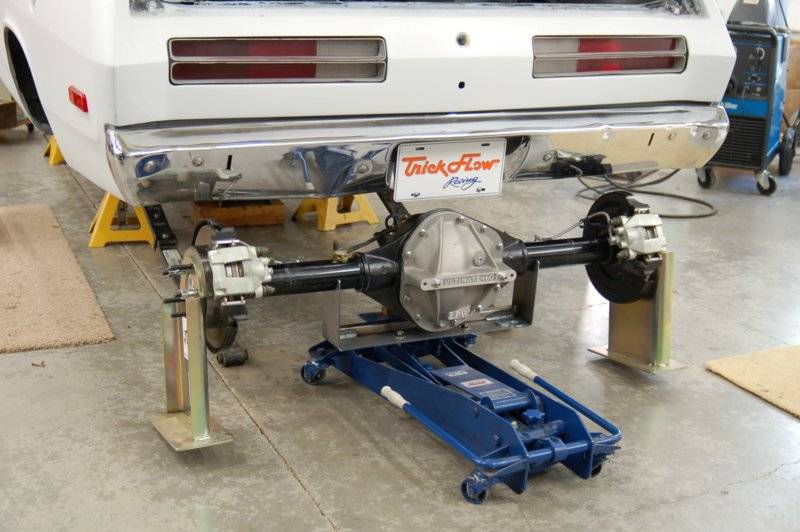

I also have a S60 from Cass under my Duster. The Duster S60 has 4.56 gears and a Detroit Locker differential. It also has Ford Motorsports disc brakes.

@andyf did you make that attachment for your jack to hold the S60 or buy it? I need one.

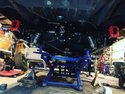

I made it. It works great. A Dana 60 doesn't really balance on a floor jack very well so if you're working alone you need something safer. I like using the transmission jack since it has tilt and roll and it can be moved sideways.
