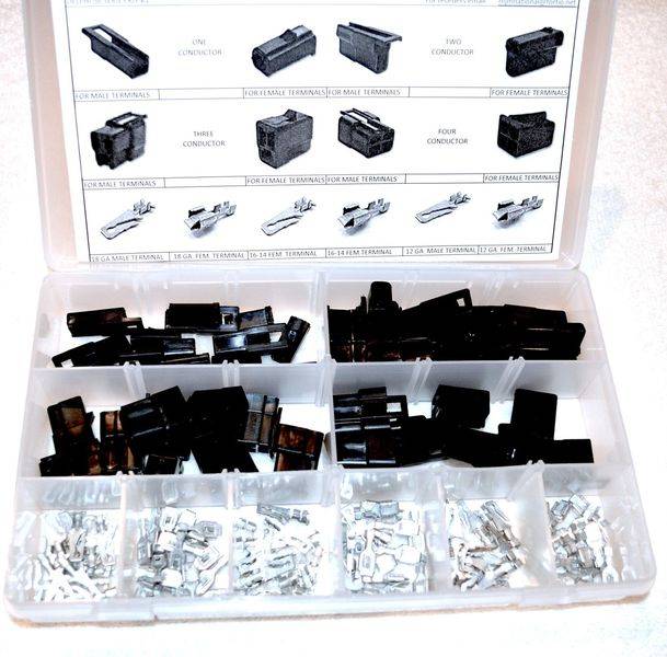

I used a set like this on my dart. Worked out great just get the right crimpers. 56 series.
also a good source where to buy and identify. There are both 56 and 58 on mopars.
https://www.forabodiesonly.com/mopar/threads/sources-for-chrysler-type-wire-terminals.418908/

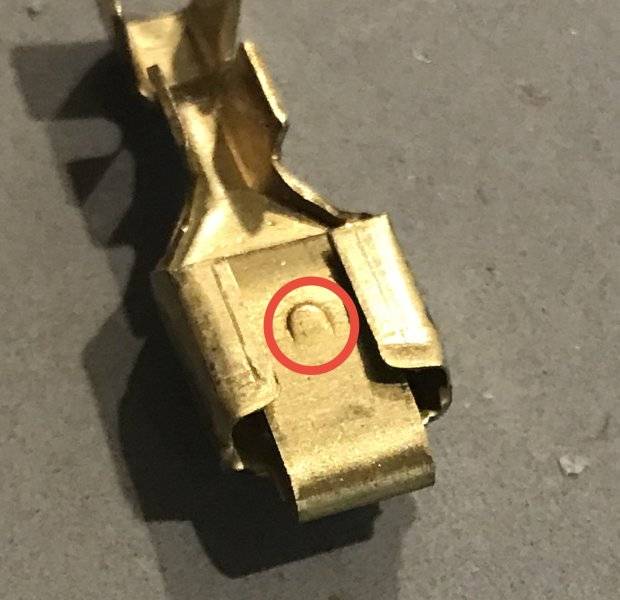

The most used on pre 74 Mopars were Packard 58s ( I just learnt this recently, thinking all where 56s with just minor upgrade differences along the years ), My car gets for eaxmple a bit of mix between 56s and 58s ( mostly 58s ). Along the years Mopars got more 56s than 58s ( 75/76 ). BUT ALL fit the same on same plugs.
56s are a bit upgrade from the 58s with the pressure tab/"tongue" which is a bit spring loaded getting better contact surface.
Later Chrysler changed the design and got their own system however sometimes you can connect a 56/58 into a Chrysler plug. Terminals don't interchange thought
My self once built engine harness and I think also forward lighting harnes made with Chrysler system ( got a donor full harness setup from some 75/77 B body at a JY ) and they fit perfectly into my 74 Charger bulkhead
