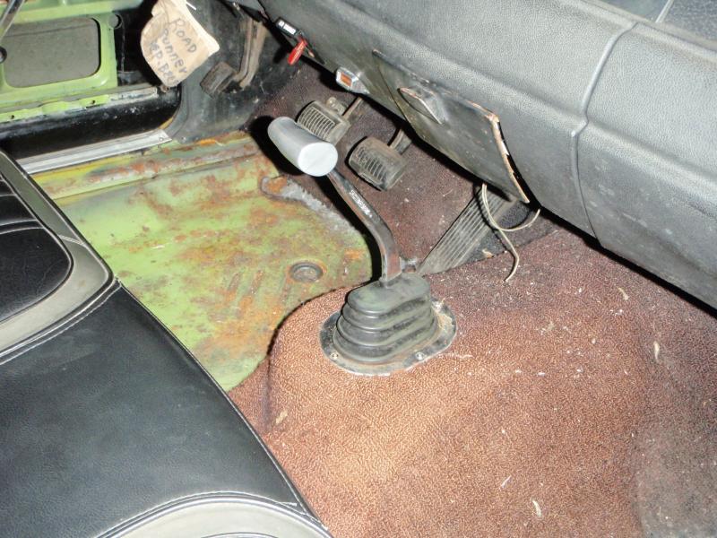

mopar-1970-b-body-non-console-4.jpg<(Stock type)Thanks for the replies. Here are the 2 shifters (one I'm considering may have to offset ) >mopar-1971-1974-b-body-non-console-w-center-arm-rest-4.jpg

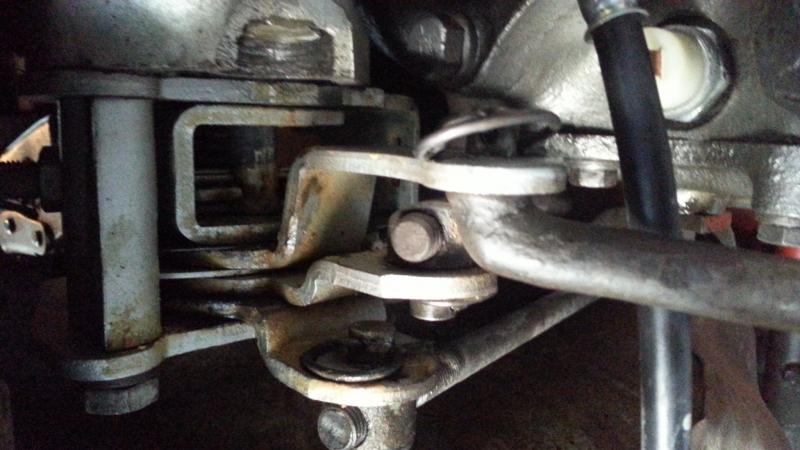

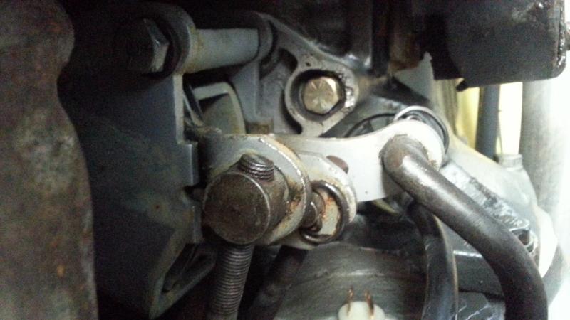

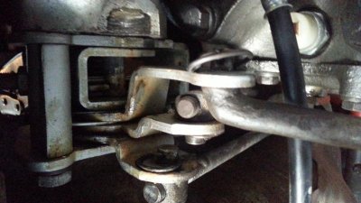

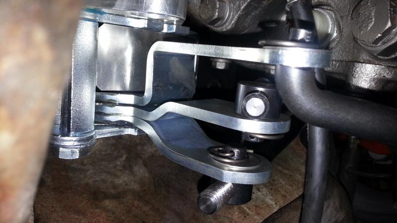

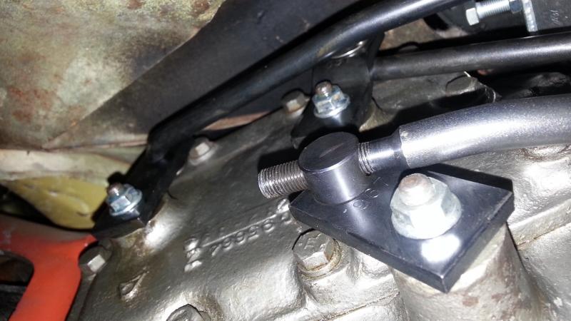

OK. I installed the Hurst Competition Plus shifter, and a really nice machined billit aluminum mounting plate, shift rods and tabs, made by Brewer's Performance. Not only does this setup work better, but what was replaced was a hot mess. The worst part of what I had was the wrong bolts being used to hold the mounting plate to the transmission. They should have had tapered heads corresponding with the tapered mount holes, but they were regular hex heads, so the mounting plate was loose. I got it all buttoned up and it is shifting nicely. Old shifter is first 2 pix, new setup is last 2 pix.
Which handle did you install? I'm also thinking of swapping to the shorter handle, I believe it's from a 71-72 bench seat car? I was curious as to how you like it. Post a few pics of it in first and second gear to show where it sits. I'm not happy with how far forward the stock shifter goes in my 70, but in 2nd and 4th it's in a decent spot. Let us know!
I kept the transcontinental time zone change 18" shifter. The previous shifter setup was such a mess that I have a significant improvement in shifting now. Slammed 2nd twice last night, much better. 3rd and 4th are great. May possibly revisit even better shifting in the future, but good for now, and worth it. The list is long... gotta move on to other important stuff for now. I also got the driveshaft cut from 51 1/4" to just a fraction over 50" which is correct for the Dana 60, and balanced with 2 new U Joints. I drove over 80mph. for the 1st time since I bought it today (closed course all legal... ahem) 100mph comes up pretty quickly and NO MORE VIBRATION/SHAKE. I was actually happy when the driveshaft repair guy (Eric at Driveline n Automotive Specialty) told me that the driveshaft was a mess before he fixed it because that was the suspected reason for the bad vibration. All good now.
