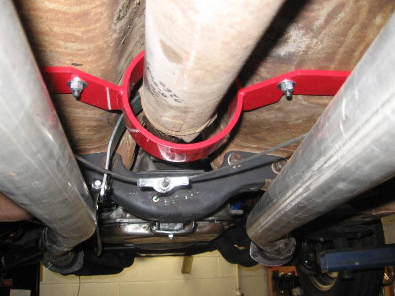

I have been putting them on all my cars for awhile now. Just an added insurance. I just get the cheep ones from Jegs and then modify them to fit the car.
This is the kind that bolts to the floor on my 63.The box said Year One on it. Came with a package deal I bought about 10 years ago.Fit real nice.On my 65 I have the one that bolts to the tranny cross member. No holes drilled in the floor. That I like.Sorry I don't have a photo of it.

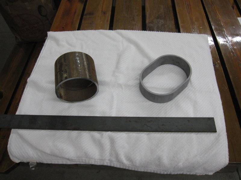

Last week I fabbed one for my 65 build. I used sections of 5" schedule 40 steel pipe and 1/4" x 2" flat stock. I'm planning to weld 3" angle iron to the edge of the drive shaft tunnel where it meets the flat part of the floorpan. Then bolt loop to the new mounts.

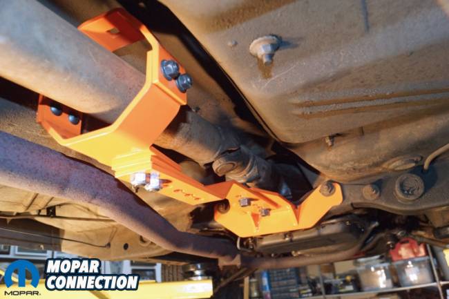

Us Car Tool and Mancini has the bolt to cross member ones.
https://moparconnectionmagazine.com...i-driveshaft-loop-without-cutting-your-floor/
http://store.uscartool.com/Bolt-In-Driveshaft-Loop-64-72-Mopar-B-Body-70-74-Mopar-E-Body_p_21.html
US Car Tool
Mancini
