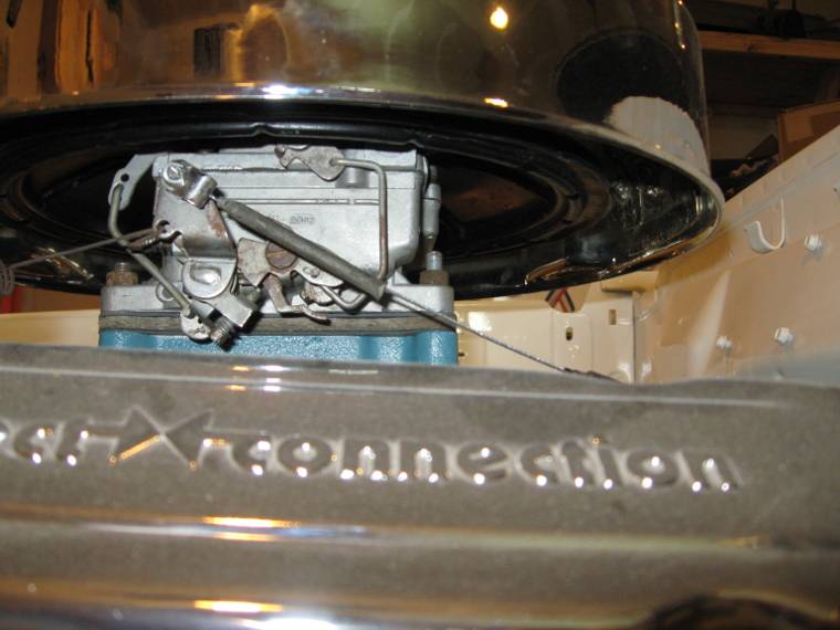

I need to replace my throttle cable on the 65 Bell . Running a 440 with a Mopar M1 single plane and a 750 Holley. I noticed that I can purchase a 1 inch longer big, block cable. Will it be required, or should I just buy a stock length cable? Thanks
Thunder

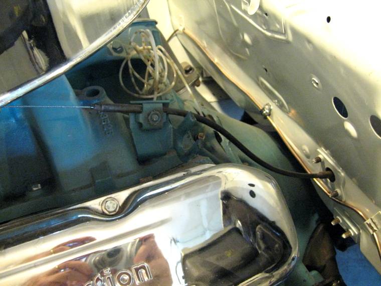

I'm running a 750 CFM AVS on my 440 with an M1 manifold and needed an extra inch or so to make the connection. I bought a generic replacement cable from Summit for about $4 ( https://www.summitracing.com/parts/pio-ca-8615 ) and just cut it to length. It fit inside the stock cable runner and worked like a charm. Had to fab the ends but that was easy.
