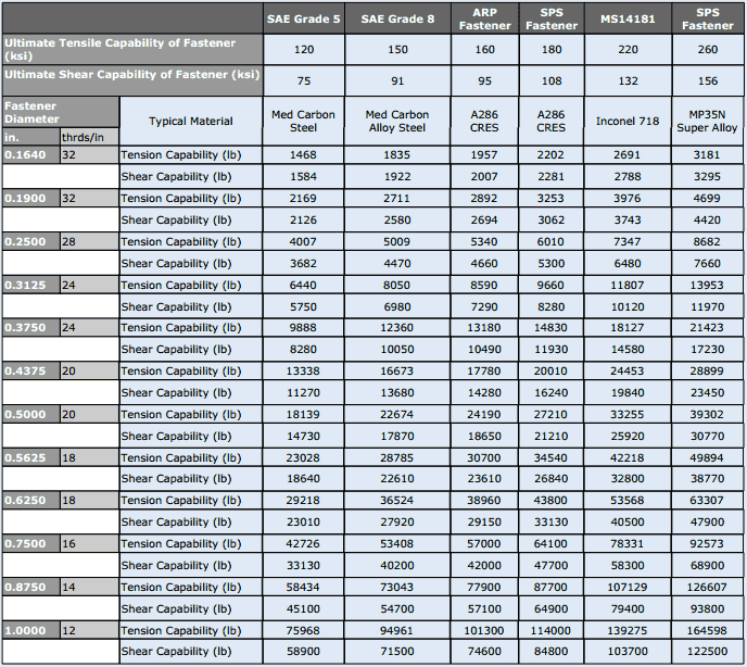

Yes. A pin does nothing for clamping force as opposed to that produced by a tightened bolt. The tightened bolt will offer not only shear force, but also the clamping force created by the friction between the pieces under compression from the bolt. So the bottom line is a bolt of the same diameter will give you more strength than a comparable pin of the same metal. A grade 8 bolt will give between 130 and 150KSI yield strength while a hitch pin only 36 KSI. Shear strength is typically 60% of tensile yield- FYI.
Here is a strength chart:
Remember that KSI is based on thousand pounds of force per square inches of cross section, so do the math and you can figure out the ultimate strength of any cross section.

68gtxman, THANK YOU you set my mind at ease. My father work in a steel mill and always said bolting parts together is stronger than you would think.And the right washers make it even stronger.Your post confirms my plan. Again many thanks.
