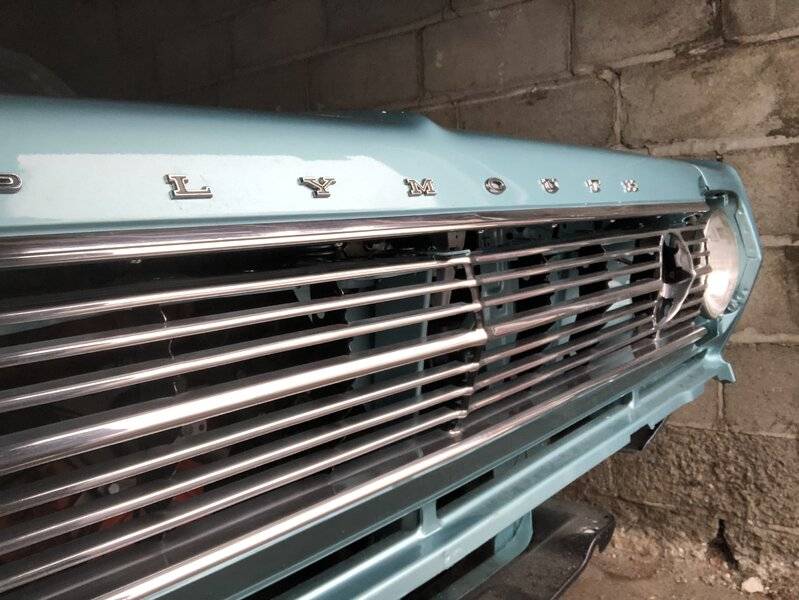

Aluminum has the anabrite coating on it. Zak took my grille and headlight bezels and removed the coating leaving the aluminum.He then polished the aluminum to look like jewelry. Now I just use aluminum polish when needed!

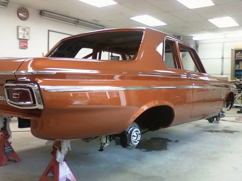

The original aluminum parts were factory anodized (surface hardened) to protect them. I just went through this process on my 64 Polara. The guy who straightened and removed all the defects required me to have the anodizing chemically removed. I used a company in Portland, OR (Electro Chem) to do this. He then did all the dent removal, straightening, ect. He recommended if the car was to be driven alot to get them re-annodized but if just a weekend warrior just keep it polished. Aluminum is a dirty metal and requires frequent cleaning & polishing to keep it looking like new. This is all a PITA but the results were good. Someone out there may have another solution (DIY) to remove the annodizing. Good luck

I didnt have to worry about the engine turn on the polara as all the side trim is stainless and my car is a resto mod. I used gold prism tape in engine turn pattern and it came out great looking against the FC7 purple paint.

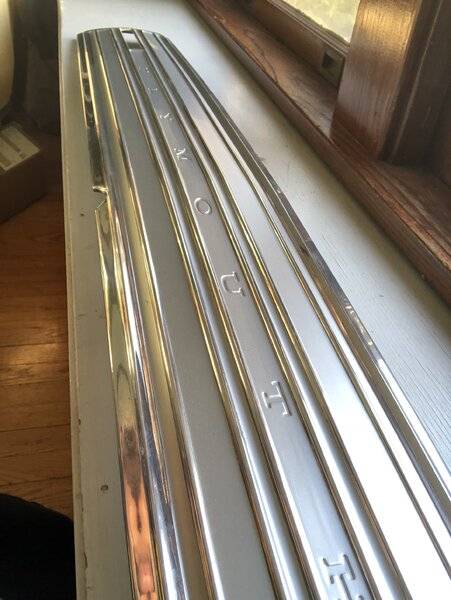

s5757s is correct, it is a PITA but they look great. Here are some pics of repair work and final product

View attachment 1039124 View attachment 1039129 I do my own trim. Stainless and aluminum. Once the coating is off the aluminum both metals repair similar. Obviously stainless is a harder material. Removing minor dents is easy. Use a piece of material with contoured to the shape of the inside of the piece you are repairing. Old hockey sticks work great. Place that material vertically in a vice. Lay the damaged part down on your form. The tool in the vice will raise the dent when you tap on it with. Hammer. A fine file will show high/low spots. Then start as coarse as necessary to remove scratches. Vary the angle of each grit. This will allow you to see when the coarser scratches have been removed. If the part is aluminum you can buff after1500. If you anodize if there are ANY pits they will show up white. Not good. I’ve left a few parts unanodized on my Challenger. They look every bit as good now as the coated parts. But then it’s only been 17 years since they were done. The 64 parts are the stainless.
Doug
wow yours look incredible. Thanks for the advice!
View attachment 1039160 View attachment 1039161 View attachment 1039162 View attachment 1039163
looks excellent to me
