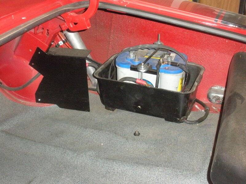

The problem persists. With a battery over 12.6 volts, the car spins over. Below 12.4, it drags like there is 20 to 1 compression!
I put the starter in in 2008. When the engine is cold, the starter doesn't spin that fast. When the engine is warm, it seems to spin faster. When the engine has been run awhile, it turns over slower but still enough to start. It never seems to crank over fast like I have heard other big block cars with the Denso mini starter. I am wondering if this starter is a contributing factor.
Last time I was going around with this problem, I found the map light to be A problem. It obviously is not THE problem.
I did not disconnect the alternator. It is charging. The voltage at the relay and battery is higher with the engine running. Can an alternator be bad if it is charging correctly ? Can a starter draw so much power that it drains a battery just by sitting? That makes no sense to me but who the heck knows. I have another new mini starter here to try. It requires unbolting and moving the header so I'd rather save that task for later if I can.
I am going back to square one tomorrow. Pulling the alternator wire, fuses and who knows what else. I have been intending on correcting a few errors with the wiring anyway. When I changed to these aftermarket gauges, some of the lighting wires got grouped together and connected to the wrong power feed. The trunk light only comes on with the key ON. The radio won't hold a memory.
