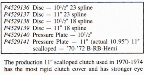

As said - look at the 10.95. The 11" is the 70-older IIRC. sometime in 71 and up they go 10.95.

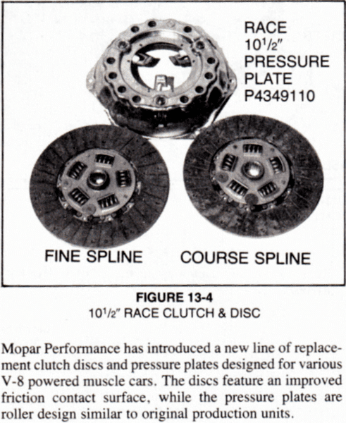

Does your flywheel have the bolt pattern for a 10 1/2" PP or an 11" PP? Might be your issue. They do offer a unit thats 10.95 that fits the 10 1/2" pattern.

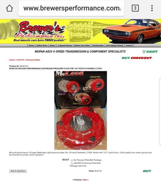

I think this is one that will fit. If confirmed, this looks like a good choice-high clamping force.

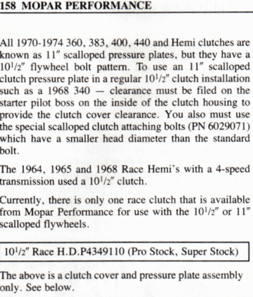

Apparently the 130 tooth flywheel and scalloped pressure plate with the associated clutch disc is an odd? combo, mainly having to do with the scalloped pressure plate and clearance for the bolts?
The 11" PP will not fit a 130 tooth flywheel of any year I have ever tried. If you have the 10.95 on a 10.5 PP patterned flywheel it will attach with a bolt that almost looks like a header bolt. To my knowledge there is nothing special about the 130 tooth 10.5 flywheel when using the 10.95 PP.
You are correct sir, especially in your description of what the pp to flywheel bolts look like. I think the "scallop" design allows the pp bolts to fit that flywheel properly.

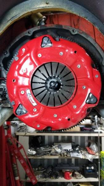

UPDATE! I installed the McLeod diaphragm style pp that they sent me directly from their manufacturing line today. 2,950 pounds of clamping force and it fits with the disc that came with the 2 year old 1,500 mile broken 3 finger unit they no longer make like a glove! New pp to flywheel bolts too. VERY precise fit! I should finish up tomorrow and will post additional information as well as the part number for the new one they sent pictured here.
See pic:
