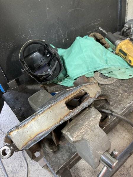

I would pull the lower control arms off and box them in. You can get the plates online or make them yourself if you have access to a welder, it’s pretty easy to fabricate. Here’s mine, I’ve also got firm feel tubular upper control arms.

Acceptable.... sure ! Reinforcing the lower is a great idea, an inexpensive method to beef up, assuming the bushings and lower ball joints are in good condition.
They seem to be, no play
