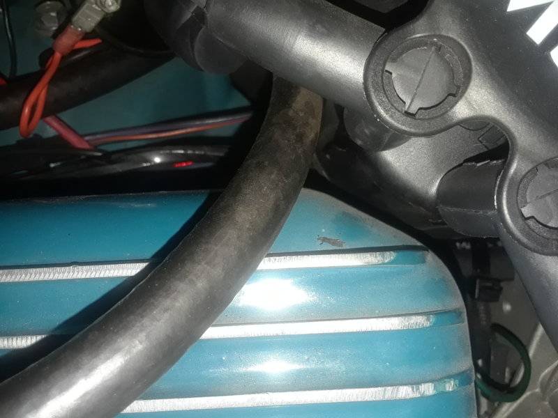

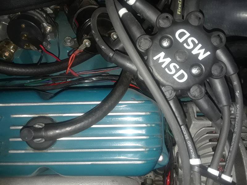

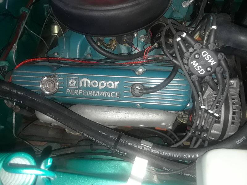

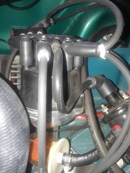

Here are a few pictures. Looking tight to pull the valve cover.
20180610_075559.jpg 20180610_075614.jpg 20180610_075629.jpg 20180610_075640.jpg
looks tight to me. like the color on the covers
Looks like enough room. Worst case take the cap off and move it over leaving the wires on the cap.
Job is done. Only had to pull the distributor cap.
