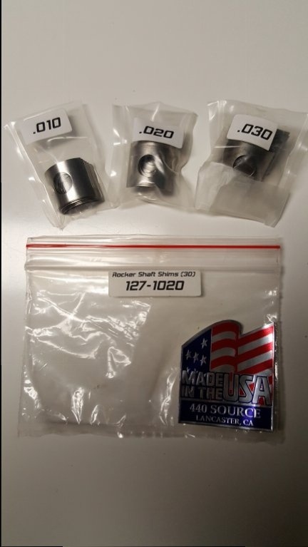

I'll give you the shims that I have and you can try them out to see what you get. Just PM me your address and I'll get them in the mail tomorrow morning. There are .010 .020 .030 ten of each.

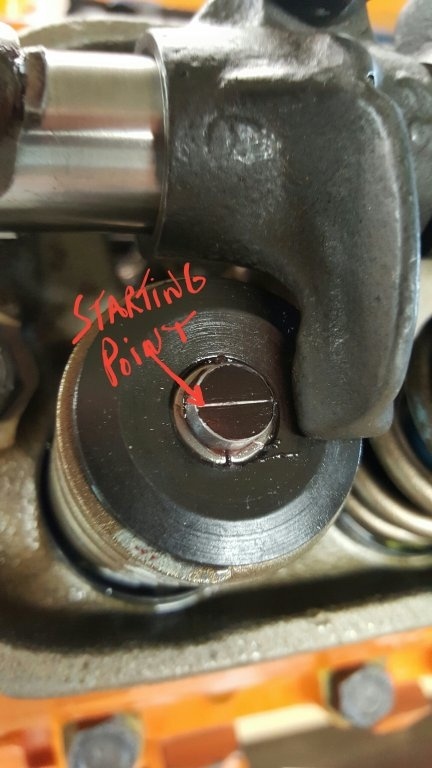

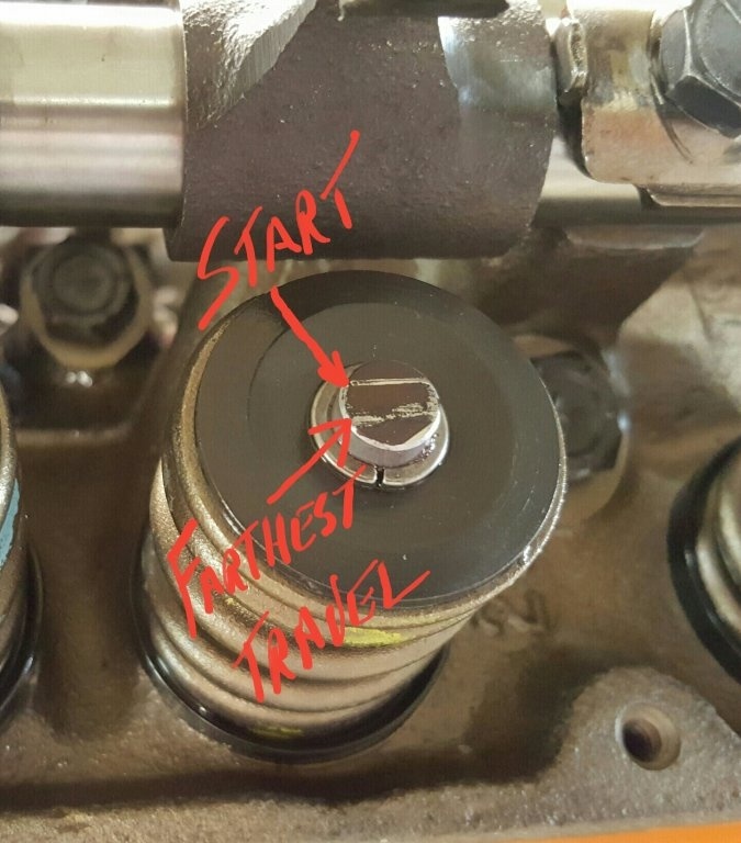

When I tried them it changed my rocker to valve stem travel way out. This pic was a .030 shim
This pic was without any shim. The starting point on a stamped or ductile rocker is off center at the top of the valve stem. Then it sweeps across to the other side, then back up. I used a marker on the valve stem, then just moved the rocker by hand, horizontally back and forth to scratch a line. This pic was what I was after.
That's very, very kind of you. Thanks!
I'm trying to interpret what you're saying the results were when using them, though - were the 030 ones giving you acceptable "sweep" or not?
But I think you're confirming what my concern was - that the shims will mess with stock geometry on these critters negatively, right?
Well you could always try them. I'm only familiar with what impact it had on my ductile rockers. Me personally, I would get the correct pushrods.
