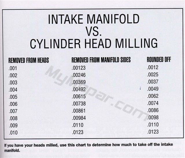

Anyway, let's get back to basics...how's that intake bolt line-up? Yeah I know...heavy. But, without gasket, which way are the manifold bolt holes, to the head holes...in, or out?
There is a chart around for the cut on intake, to keep up with cuts on the heads. Or, if in a pinch, oblong the intakes holes.

Thicker head gaskets=lower CR. Might not want to mess with it, but there's a cut chart for intake/head...(can't find mine right now)

Here it is...

The chart I posted is pretty much guideline stuff...most of the time, might not even needed, unless things are extreme. All just for port and bolt hole line-up.
