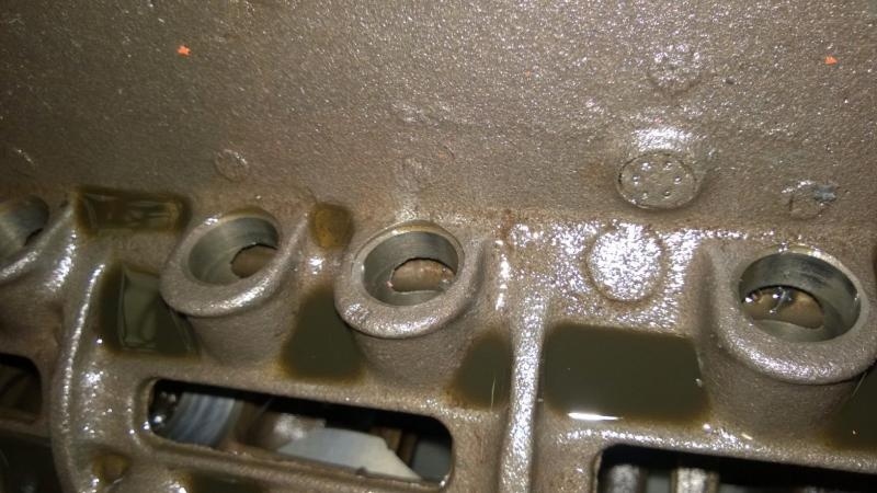

I found a couple pics from the last time I did the cam swap:
Wonder if that shot of the lifter valley shows anything?

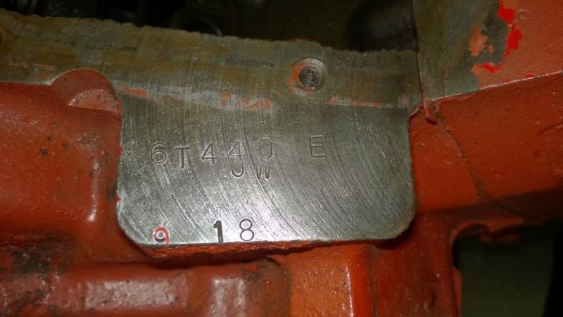

Oops, my bad - 6T means it's a '76 block!
The E means cast crank, but this one's been swapped out and if memory serves, it sure looked like a forged one to me back when.

Like dd says- frt lifter sure looks bigger in dia. I say keep the block you have & go for it.
Yep for 500 you could get the lifter bores bushed if needed. I'm bettin that the cam bearings were installed at a machine shop that builds Chevys :rofl:
I noticed that also but I think it's camera angle playing tricks on us. But the cam bearing sure looks like it's been starved of oil.
That far right lifter bore looks funny to me. Looks like there are shiney spots almost as if the the bore itself wasnt honed when it was machined or maybe it was and now its oversized enough that the lifter is getting cocked in its travel. Is that one of the lifters that got munched with the old cam? I agree about the cam journal bearing looking so so . The bottom half of the bearing is going to have a little more wear on it due to the downward pressure of the lifters being pushed by valve springs. Ive seen worse and the valve train was ok not perfect but ok. Id start to really focus on lifter bores and lifter rotation when you start checking things
The harmonic balancer will tell you , at first glance, if it is external balanced cast crank . or internal balance forged crank...Unless it has the wrong balancer installed........................MO
