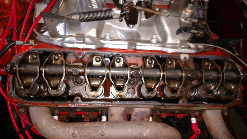

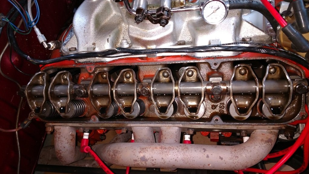

Like IQ52 & other professional engine builder have said &
most of the other members here too...
Take it apart, completely tear it done completely,
inspect & clean every orifice & every inch of that block,
have it steamed out & pressure washed before you proceed
it could be a litany of issues
from bad or improperly installed camshaft bearings,
to bad parts {even if they are new}
to bad or the wrong oil to completely wrong break-in procedures
{regardless of the types of oil used}
to even maybe not priming it before starting
to maybe rocker shafts installed upside down
not oiling stuff or rockers & pushrods etc. properly
resulting in spreading various & numerous metallic particulates
throughout the engine "multiple times now it sounds like"
oil pan to oil pick-up clearances wrong too close or too far way,
starving it of oil etc.
or a combined total of a few or all the above...
dirt & shavings/metallic particulate would be my 1st guess
