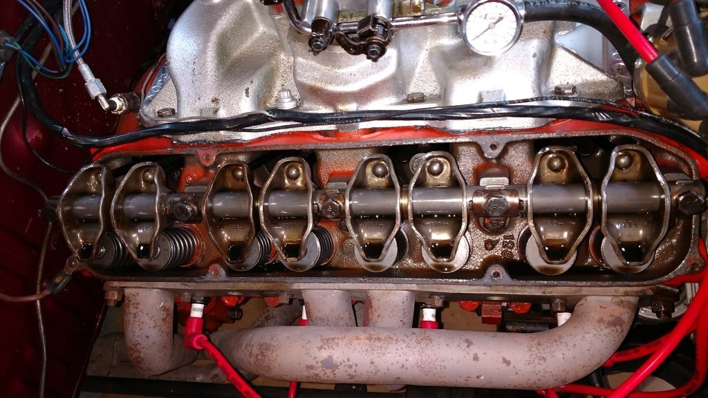

View attachment 388185 Drivers' valve cover off. Rockers all snug, no sign of collapsed lifters or wiped lobes. Oil evident on all rockers.

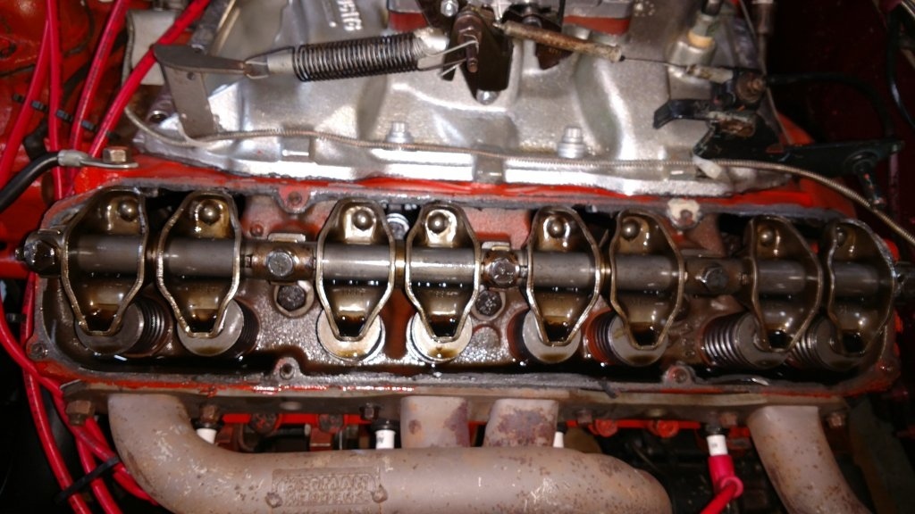

Passenger side now. Ditto on comments. All appears well.
It appears ok, next thing, I would pull the dist and use a primer rod and variable speed drill to check oil flow, and if you have mechanical guage run drill till you have 40-50lbs. oil pressure. Don't forget to turn camshaft to make sur you are getting oil to both banks. Make sure you are getting oil to all rockers good luck.......................MO
Hey CM, thanks for the advice.
You still think that's necessary, though? Pretty convincing evidence of oil getting to the rockers here, especially since it's been almost three weeks since it last ran.

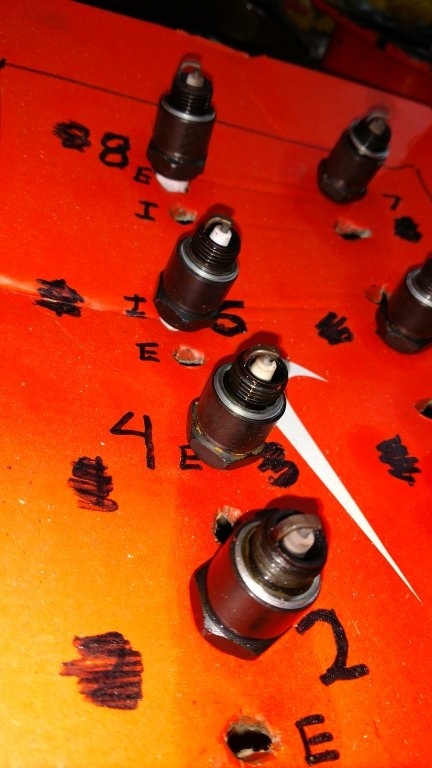

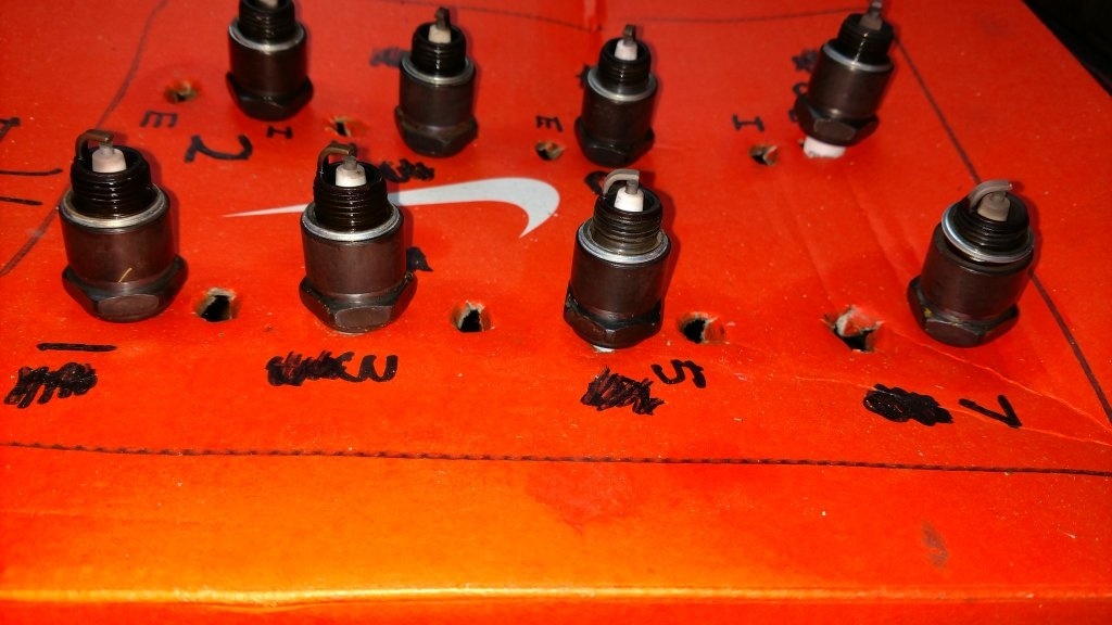

#5 looks clean as new ??......................MO
Pretty close, yeah.
All 4 middle ones do, really; they look really lean.

We do know the intake fit poorly and was tough to install. We also know the plugs do appear different. How long was it run recently before they were pulled? Pulling a plug after driving into a garage or a slow drive around town shows NOTHING about mixture.

Ok then, assuming that, I guess the answer for the plug differences could be because I was running the heat block-off bathtub, like I read about?
