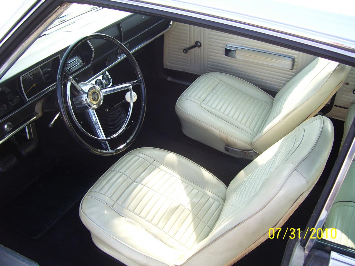

The guy I got the car from said they were the originals but,.... I knew better. I just dont know what they came out of. Anybody know?

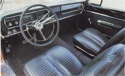

Possibly recovered but they dont look like org. as in pic below.
Kinda look like my 72 plymouths
Forgot what the backs look like Curt. I thought 69-71 B body. Hate to say it but they be GM?
They are 1970-up because they have the built-in high back headrests. The seat pattern looks GM.
More investigation needed to determine what they really are from. If you take them out and look at the bottoms of them they may have a partnumber metal tag attached to the seat springs.
If you take the seat backs off of them and they are Mopar you may find a broadcast sheet in them that will ID what they came from originally.
Almost look like Mustang...maybe 77ish??
I was looking at yearones web site and they are.......................................67 OR 69 Fireturd, and from what I could tell those are the only two years you could get them in white. I was leaning more towards mustang but the are definetly fireturd. I would like to get the original style for my car even though these dont look that bad in there,....it just kinda taints it now that they are not atleast out of a Mopar! lol
