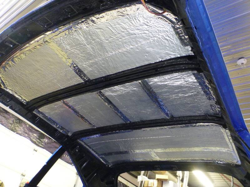

If you go with silver foil... do yourself a favour and mist it with flat black paint. I can see it shining through the headliner holes.... and wish I had done so!
