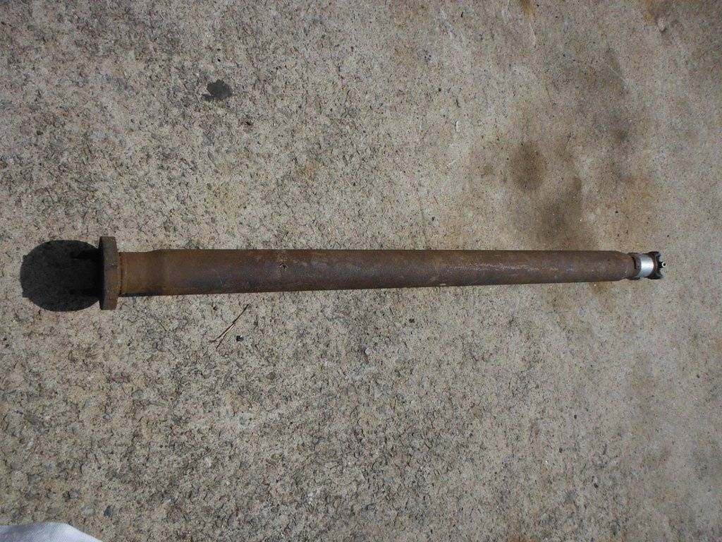

My 1968 GTX has one of these type driveshafts in it. It was originally a 440 automatic, now is a 4-speed:
It has that welded "donut" at the transmission end like the one in the pic above (pic is not my actual driveshaft). Were those used in 1968?
The u-joint in front measures close to 1 1/4" cup diameter (!), but I wonder if that has a larger head due to these having internal retaining clips?
I'm in process of fetching a replacement yoke and this is the time to make any corrections, if needed.

Can't tell ya the cup dia. But the 68FSM says 52.07" length, 3.0" dia. with inertia ring(donut) for all 383,426,440 with 4bbl. For some reason a 383-2bbl is 52.03" & 2.75" dia. even with both having 8-3/4" diff w/auto.

Ah, so that's an "inertia ring" eh? So this could actually be the original driveshaft for the car?
Could be, I think you measure from centerline of each cap.

In case anyone stumbles across this thread in future years, I'll answer my own question since nobody else has so far:
The driveshafts with the inertia ring front end on them (and bigger u-joints) were stock on 440 and hemi b-bodies in 1968, regardless of transmission choice.

Mine has the inertia ring front on it like the FSM says.
