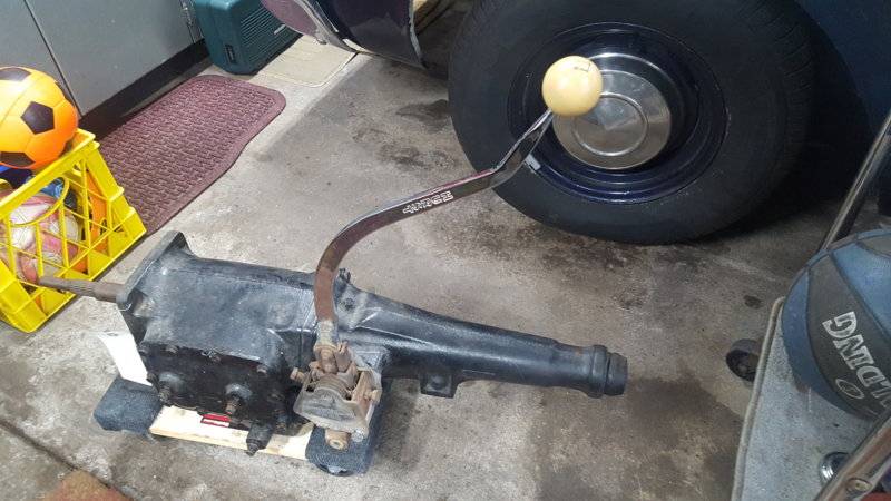

So, I have a 66 trans, and a Hurst that was in an original 70 b-body 4 speed as a replacement decades ago.
Brewers lists a complete shifter package for 66-70, and 62-65 with A833.
They also list rod kits for 64-69 and a separate rod kit for 70.
Not sure why the 70 rod kit is separated.
I might have a source for used rods, but the shifter kit pic shows different rods than the rod kits, and the rod kits have the same pic.
Do rods have numbers stamped on them?
Anyone know what rods will work?

I only have what's in the pic, no rods or levers.

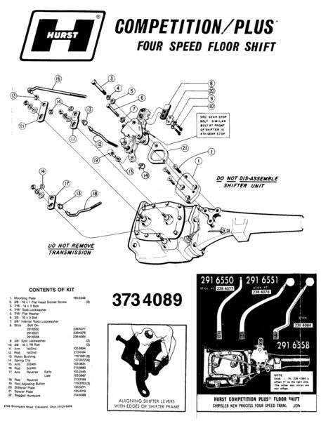

Found the 373 4089 install kit instructions for the 391 6789 Hurst, which are both included in Brewers SP6789PKG, or any similar 65-70 b-body Hurst package.
I don't see the rods or arms listed separately on Brewers site, or the spacer.
My shifter is 6370.
I'm going to call Brewers and see what's up.
